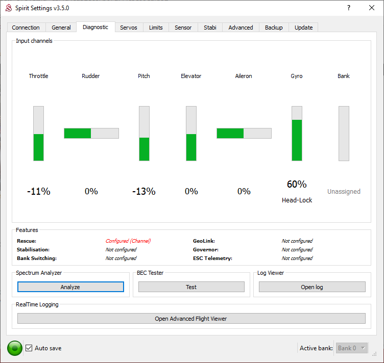

franz88
Posts: 340
first go in servo- subtrim (tuning) and put the blade as in the photo and spin the rotor 360 degrees
the two blade they always have to touch they must not have unlevel different at 360° in all position
general- channel
f stabi function changhe in f:rescue normal
select stabi - function
and select select by channel
finally diagnostic - rescue the red writing
configured: channel when it is deactivated and written blue when active (is automatic)

Thanks for helping me diagnose the issue.
I have check subtrim in all orientations and it is spot on, no discernable difference in the height of the blades in any orientation.
Rescue is also set up correctly, pictures below.
