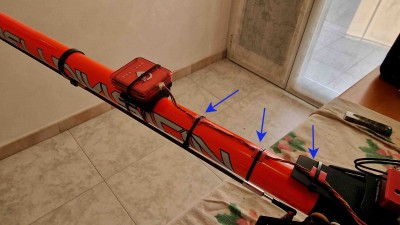

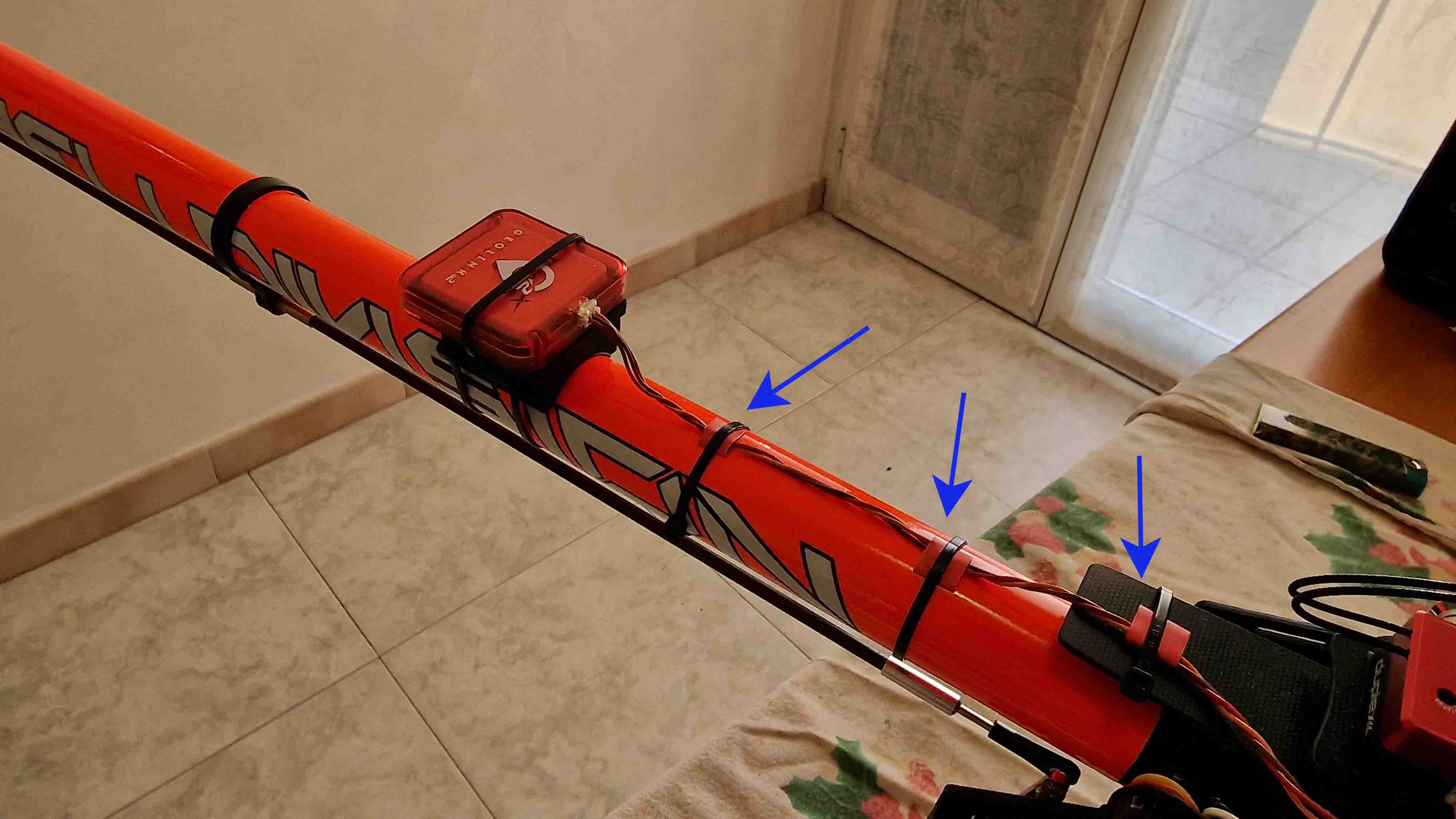

as you can see from this photo the basis of the geolink it's a nice double so i think the problem could be the wire.
as you see the wire walks on the tube and next to the spirit there is a carbon base.
I put heat shrink tubing and electric clamp.
I can try a strip of electrical tape and the wire I touch it on the electrical tape to distance it from electrostatic discharges.
Do you think I can be right?

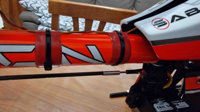

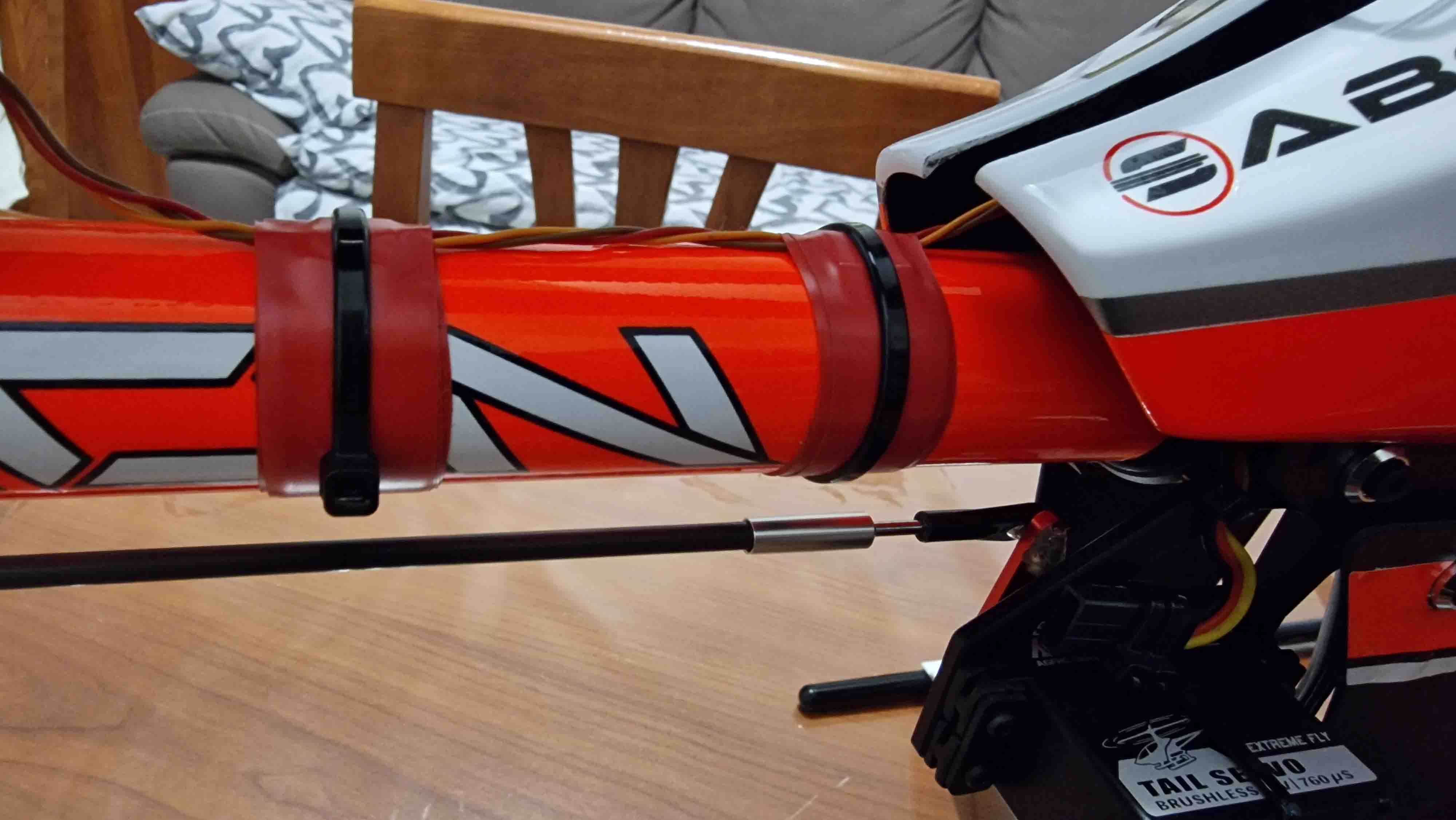

now my helicopter is uglier and it hasn't changed.
I inserted a layer of insulating tape then the geolink wire and another layer of tape on top.
Then after an electrical clamp.
After I removed the fan of the hobbywing esc.
I always get the error geolink connection broken.
