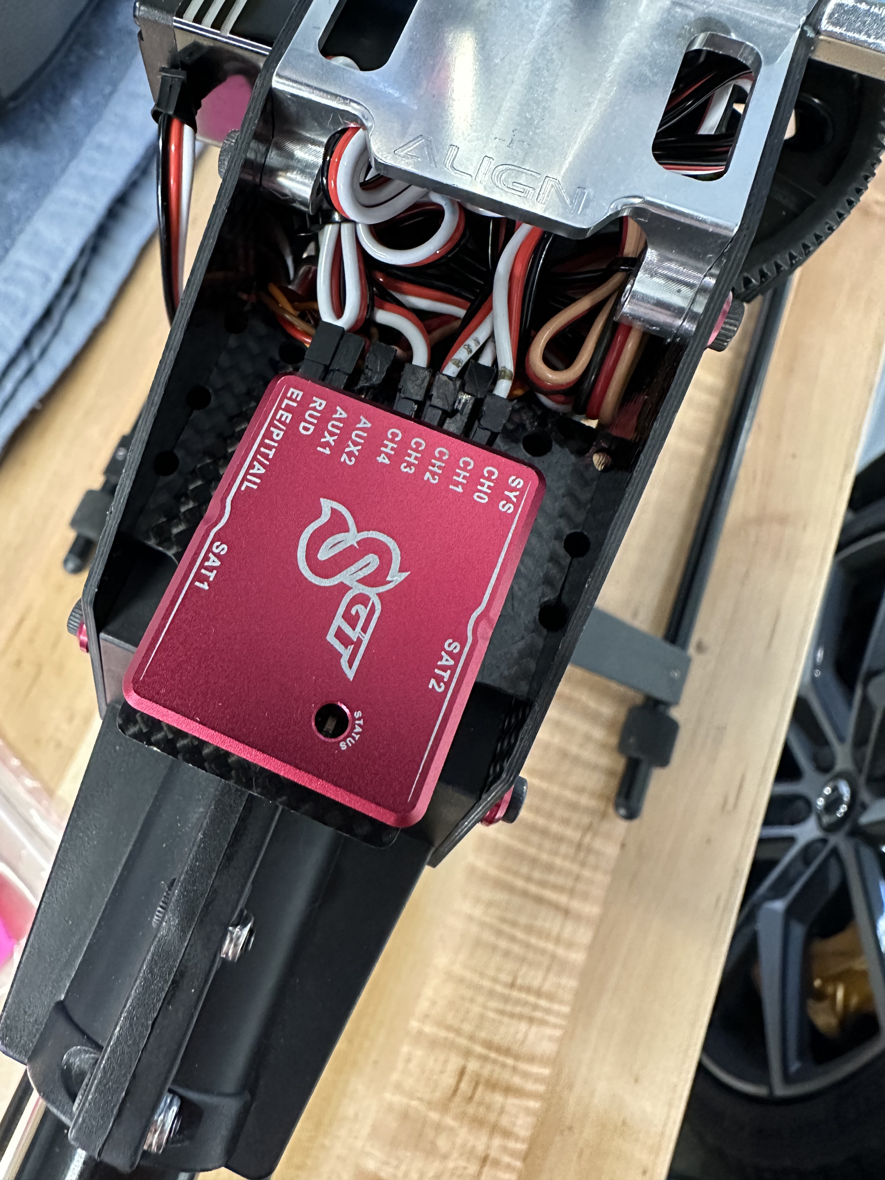

Can you please take a photo of how your unit is mounted?
See attachment.

The unit is new, purchased from HeliDirect on September 10, 2023. The screws on the Spirit unit do not appear to be loose. I am using the tape provided to mount it.
The unit mounted on my 550E. Pins are facing the front of the helicopter. It is mounted where my FC6250HX was mounted.

thank you very much. Settings and mounting is looking quite good, except that one servo connector is almost disconnected in the Spirit unit.
Tomorrow we will ship you new Spirit GT for comparison with FedEx Express. I am out of ideas if it all is good.

I noticed that connector right away, too. It had pulled out when I removed the programming cable to download the settings. I assure you it is always fully pushed in during every flight.
