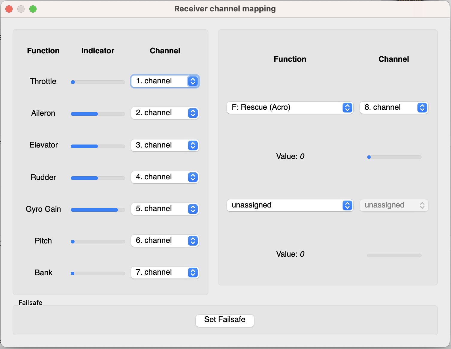

Then make sure that your channel layout is default - at both Spirit unit and JETI radio.

I just verified to confirm. I left channel assignments for channels 2 to 6 to default on the Spirit, and correspond properly to the channels 2 to 6 assignments on the Jeti radio. I assigned "Throttle" to channel 1 (Spirit and Jeti) and "Bank" to channel 7 (Spirit and Jeti). I assigned "Rescue (Acro)" to channel 8 (Spirit and Jeti). I calibrated all the channels (high/mid/low) with the Jeti radio "Servo Setup".

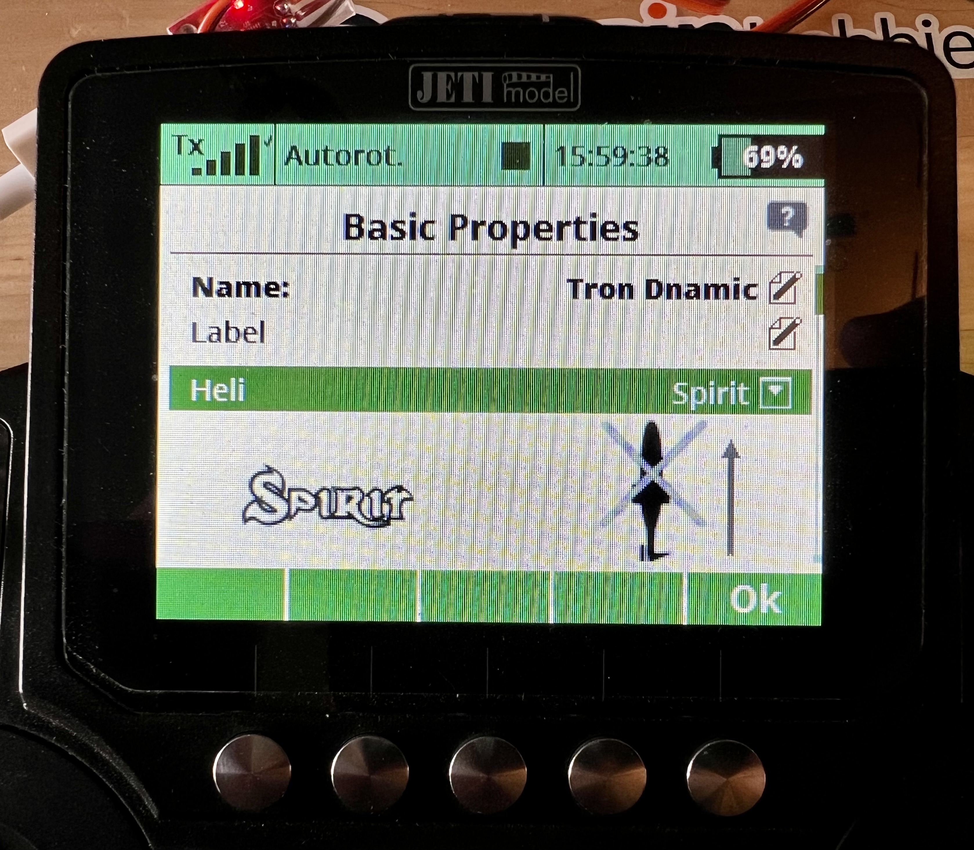

I chose "Spirit" on the Jeti radio "Basic Properties >> Heli" page.
