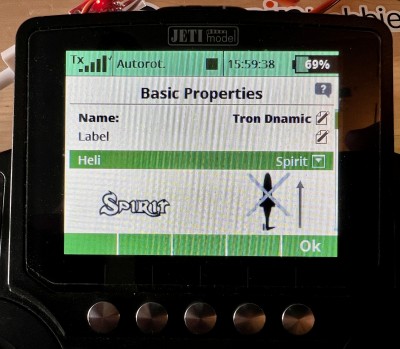

Have you selected Spirit model type in the radio - base model setup page?

I chose "Spirit" on the Jeti radio "Basic Properties >> Heli" page.
