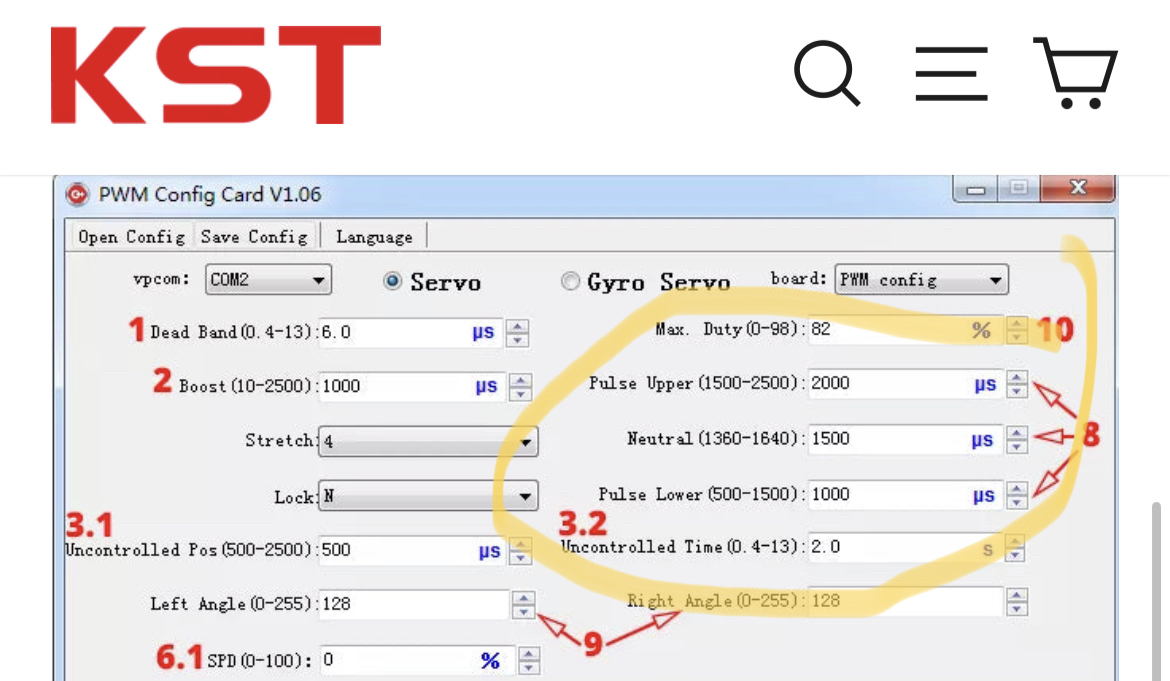

Upgrading servos to KST BLS915 V8, I'm just about to try a 760us cyclic setup.
The servo programming tool takes Upper/Neutral/Lower settings, what is the upper and lower numbers?
Do anyone know if theese servos do more than 333Hz, and do I need to select the 20_k in the servo programming tool?

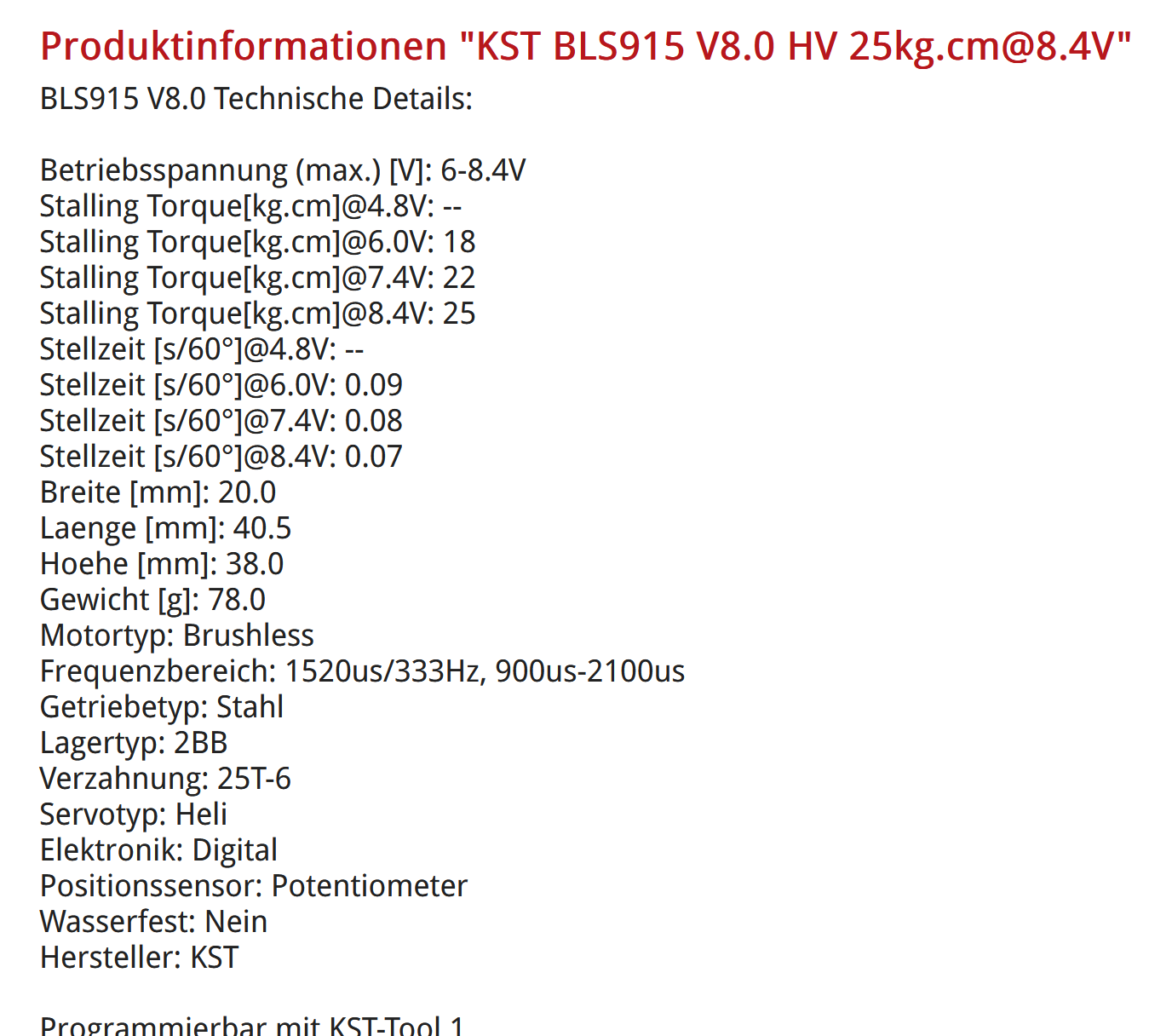

this servo can only 333Hz and neutral signal at 1520 µs , why do think it can 760 µs ?
With the KST1-Tool you can only set the neutral position and the left and right endpoints.
The only information I found for KST1-Tool is in German, look at this:
Servoinformation:

Specs makes me think so:

Wat will the low and high value be when going for 760us?
