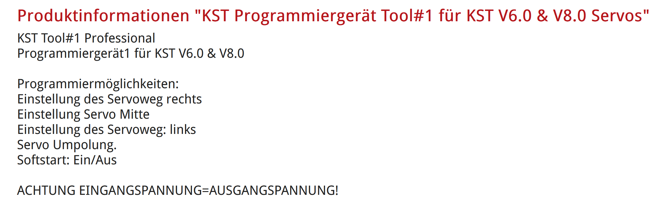

With the KST1-Tool you can only set the neutral position and the left and right endpoints.
The only information I found for KST1-Tool is in German, look at this: Servoinformation:

really interesting, different languages different information ?! Unbelievable !
I find that strange...
In the german manual there is no information about the change of mid signal...
I think the only secure information is directly from KST or maybe an other user has this type of servos and changed the mid signal to 760µs -
