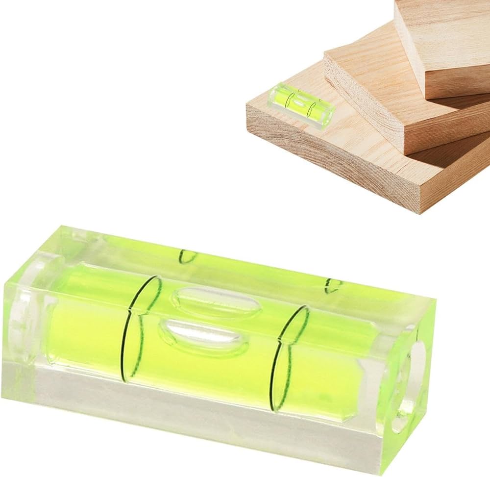

When you use digital pitch gauge absolutely do not let it turn off.
Put a bubble digital pitch gauge and set 0.
After put the digital pitch gauge on a blade and put the blade on the nose after right after tail after left, the important thing is that you always measure on the same blade and digital pitch gauge it must not be turned off.
Do not put the digital pitch gauge first on a blade after on the other blade.
with everything standard spirit It flies really well
for me it all depends from how you set the 0 degrees the +13 and -13.
Many people get the system wrong.

I did it a bit different. Yes, you are right. All measurements for the blades should be done with one calibration of the gauge without switching off between.i have sab goblin raw 580 wit spirit and is perfect my model.
for raw 580 you put this
on t hub and level tail-noise and left-right why raw it is inclined
after you use this bubble on digital pitch gauge
but maybe it's better if you see my video just look at the 0 part (I speak Italian but on youtube select automatic translation subtitles and subtitles appear in your language)
