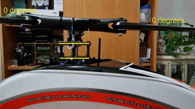

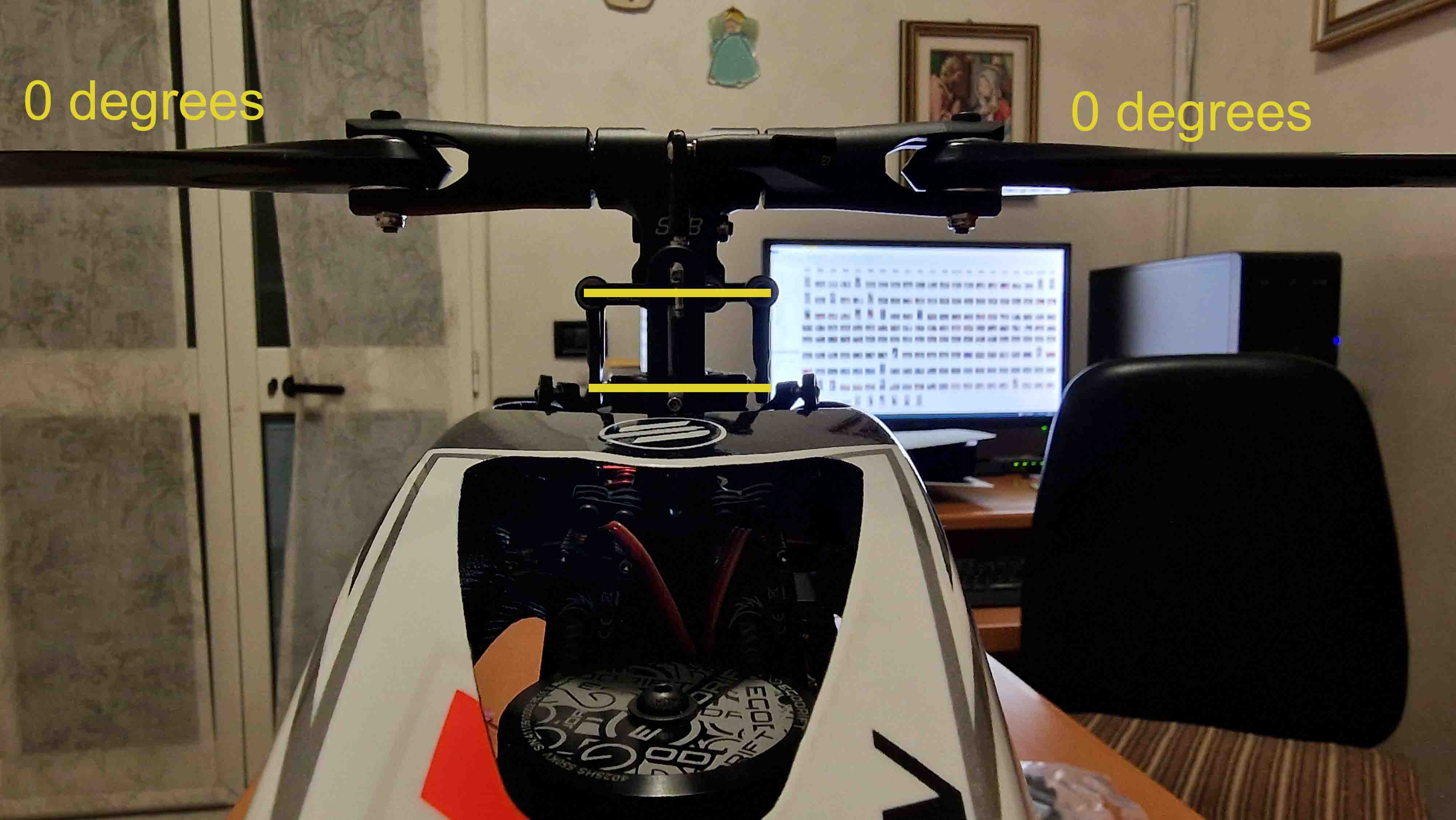

i have sab goblin raw 580 wit spirit and is perfect my model.
for me it all depends from how you set the 0 degrees the +13 and -13.
Many people get the system wrong.

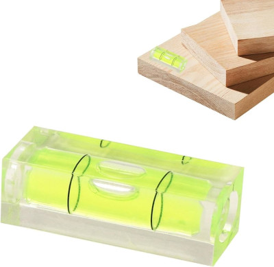

When you use digital pitch gauge absolutely do not let it turn off.
Put a bubble digital pitch gauge and set 0.
After put the digital pitch gauge on a blade and put the blade on the nose after right after tail after left, the important thing is that you always measure on the same blade and digital pitch gauge it must not be turned off.
Do not put the digital pitch gauge first on a blade after on the other blade.
with everything standard spirit It flies really well

franz88
Posts: 343
for raw 580 you put this
on t hub and level tail-noise and left-right why raw it is inclined
after you use this bubble on digital pitch gauge
but maybe it's better if you see my video just look at the 0 part (I speak Italian but on youtube select automatic translation subtitles and subtitles appear in your language)
the spirit is perfect It all depends on how you set it up my parameters they are all standard
when you select the wizard asks you what model you have I selected sab raw 500/550/570/580 and stop I didn't change anything else.
Maybe some setup you didn't do well because there is nothing special to do.
Check out my method
https://youtu.be/YM6Caw9GZh0?si=lEFAni6Drrp5HpQG
you what method did you use?
on my channel there is video and see how well it flies sab goblin raw with spirit

with servo 90° you must have your head aligned the photo is the same in all position and 0 degrees in the blades (I repeat the Sab Goblin Raw 580 It has landing gear inclined Isn't it because you didn't calculate the inclination?)

but you what a procedure you used to set 0 degrees of the blades?
