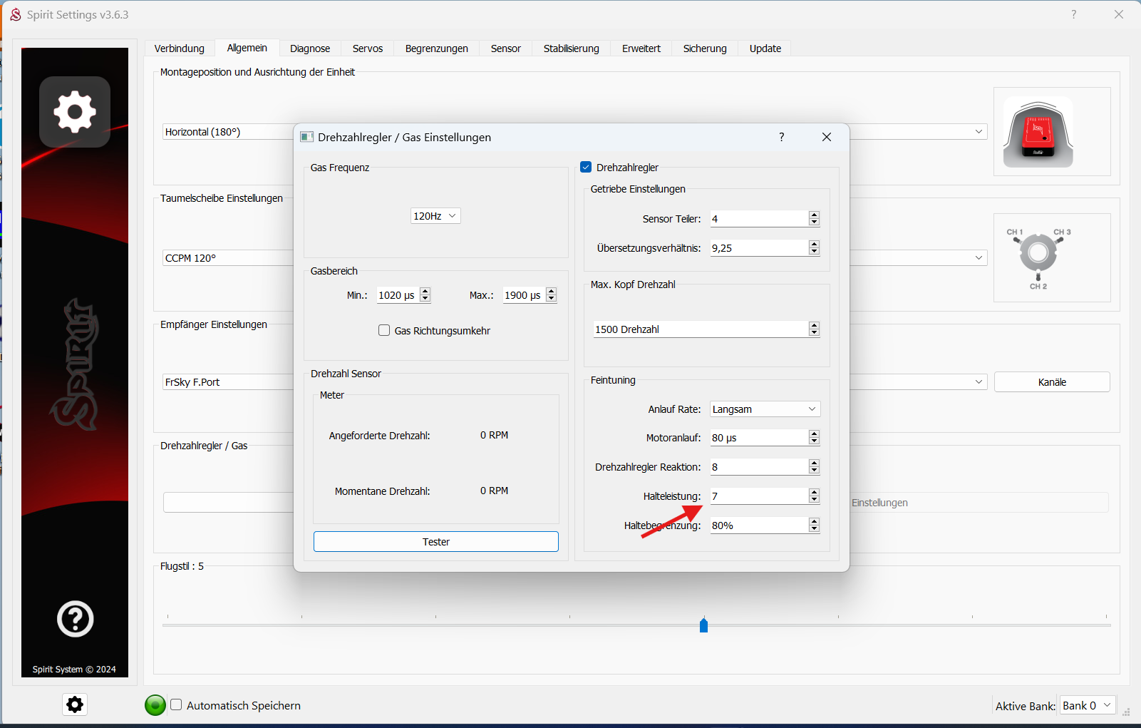

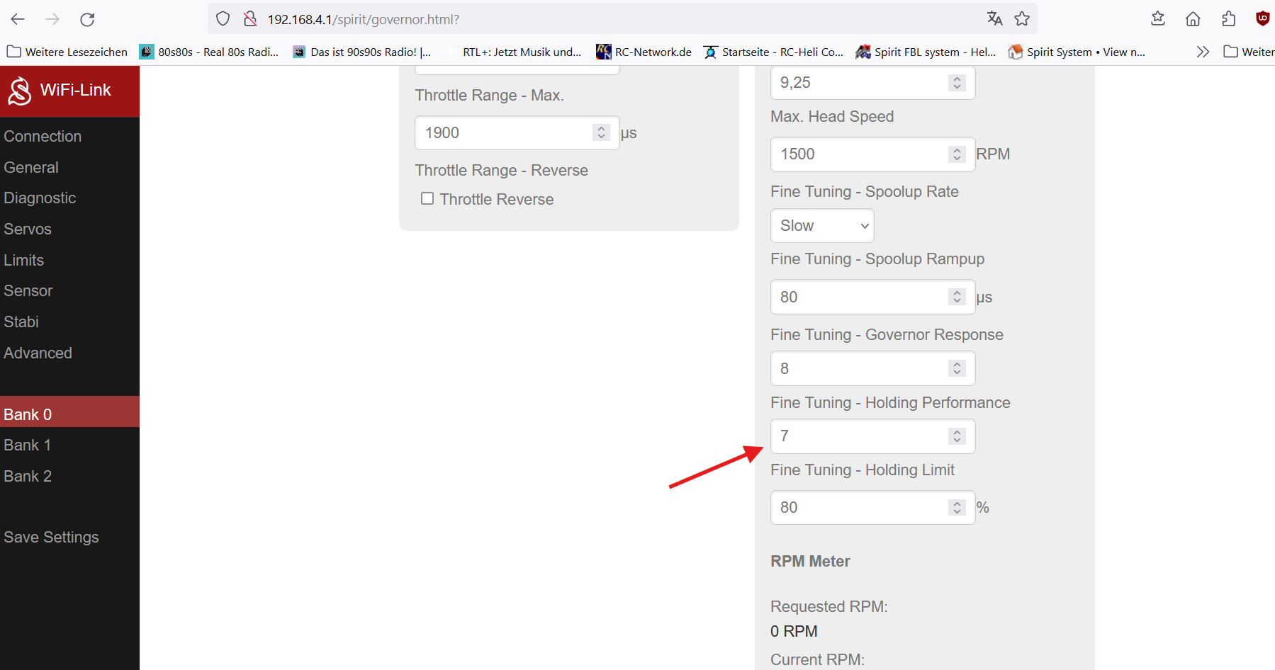

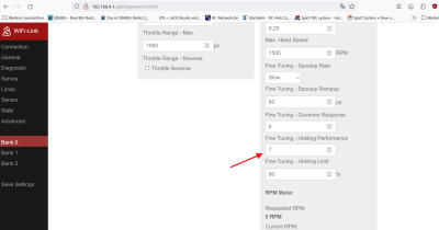

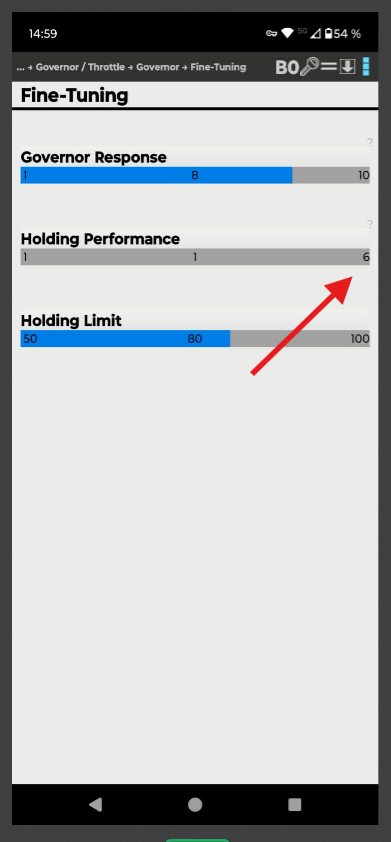

Today on the airfield I wanted to change the governor settings of my helicopter, unfortunately I had to realize that the Ethos integretation no longer works.
So I wanted to make the settings via Bluetooth and Android app, but the setting range for Holding Performance only goes from 1 to 6, while the setting range for the PC software and WIFI link goes from 1 to 10.
What is going on?

There is only the android app showing another value (marked with the red arrow) - maybe only there is an mistake ?
Posts: 12887
thank you for your message. You are right. Android wpp has lower upper range by mistake. Because of this parameter value is not loaded there.
