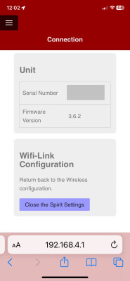

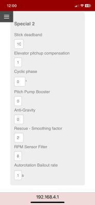

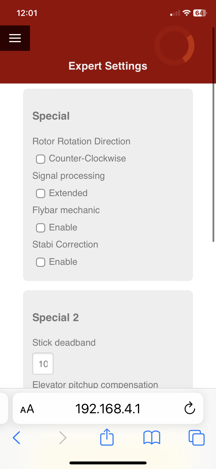

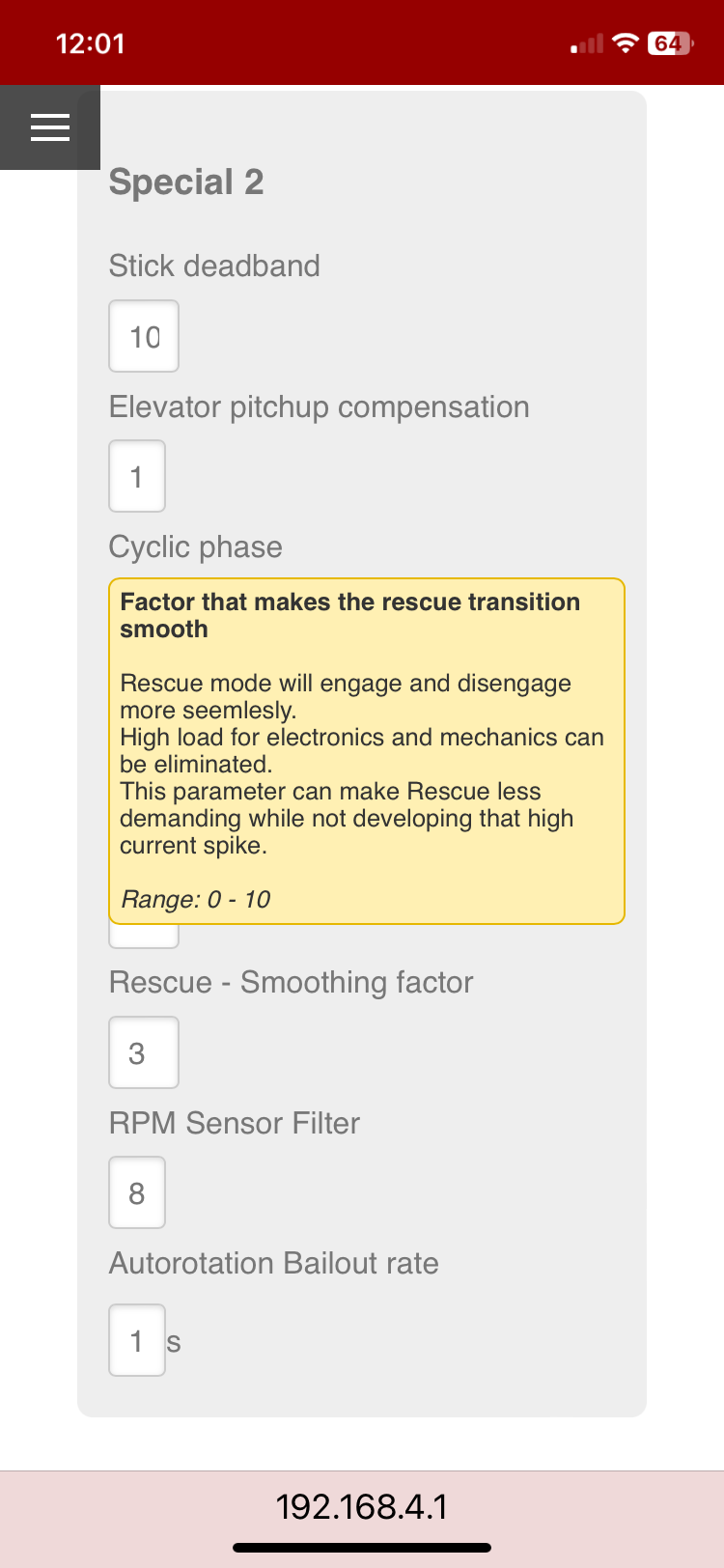

I can’t change the rescue smoothing factor using my iPhone. The other settings on the expert settings page can be changed without issue.

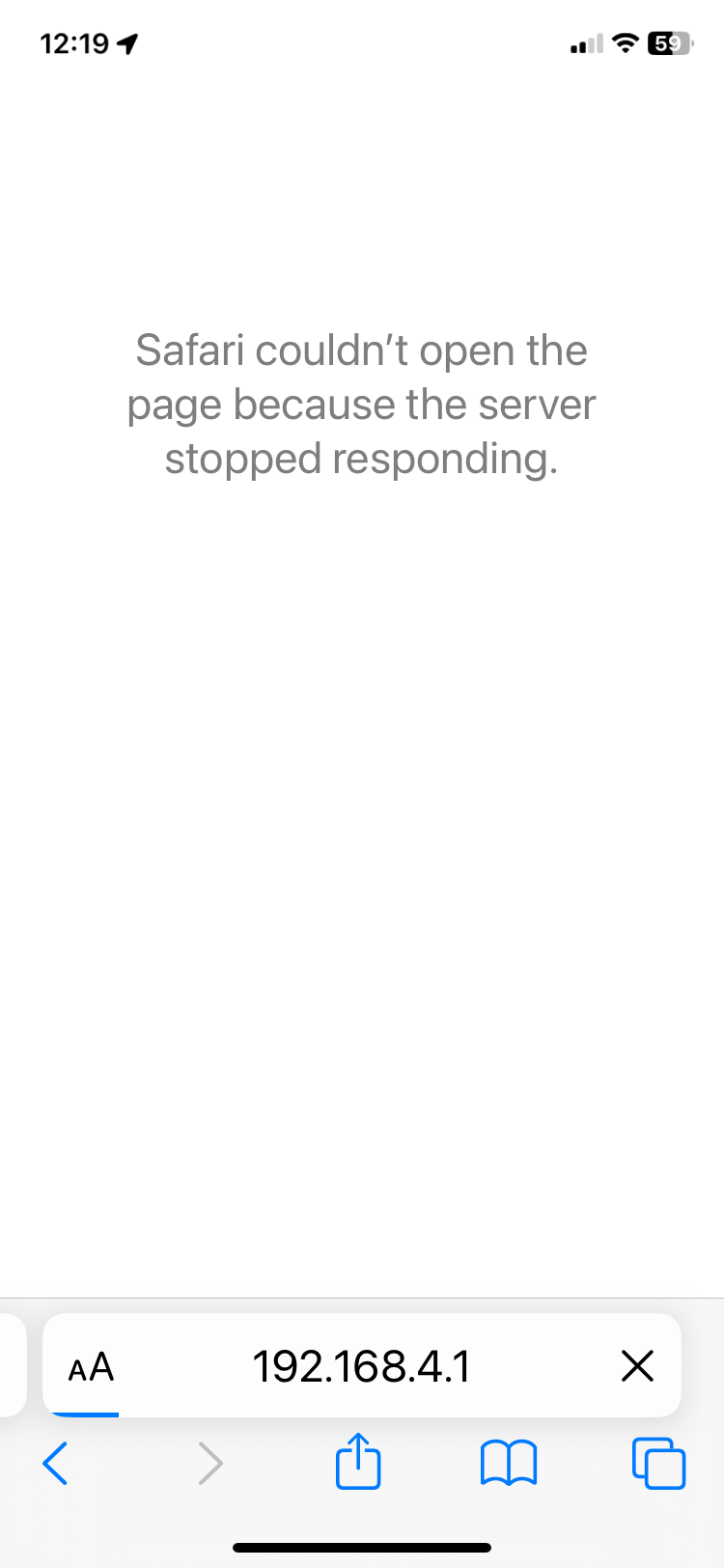

When I change the rescue smoothing factor value, the page shows it’s loading, then it shows connection problem, then returns to the connection page. Sometimes, the web page disconnects from unit while iPhone shows it’s still connected to the spirit WiFi link network.
Same behavior happens using Microsoft Edge in a laptop computer.
I was able to change the rescue smoothing factor using the Spirit settings software using the WiFi link connection.

Updated Spirit pro, settings software and WiFi link, to version 3.7.0.
Rescue smoothing factor still cannot be changed using the settings web page on iPhone Safari browser or MS Edge browser in computer.
It does what is explained above.
