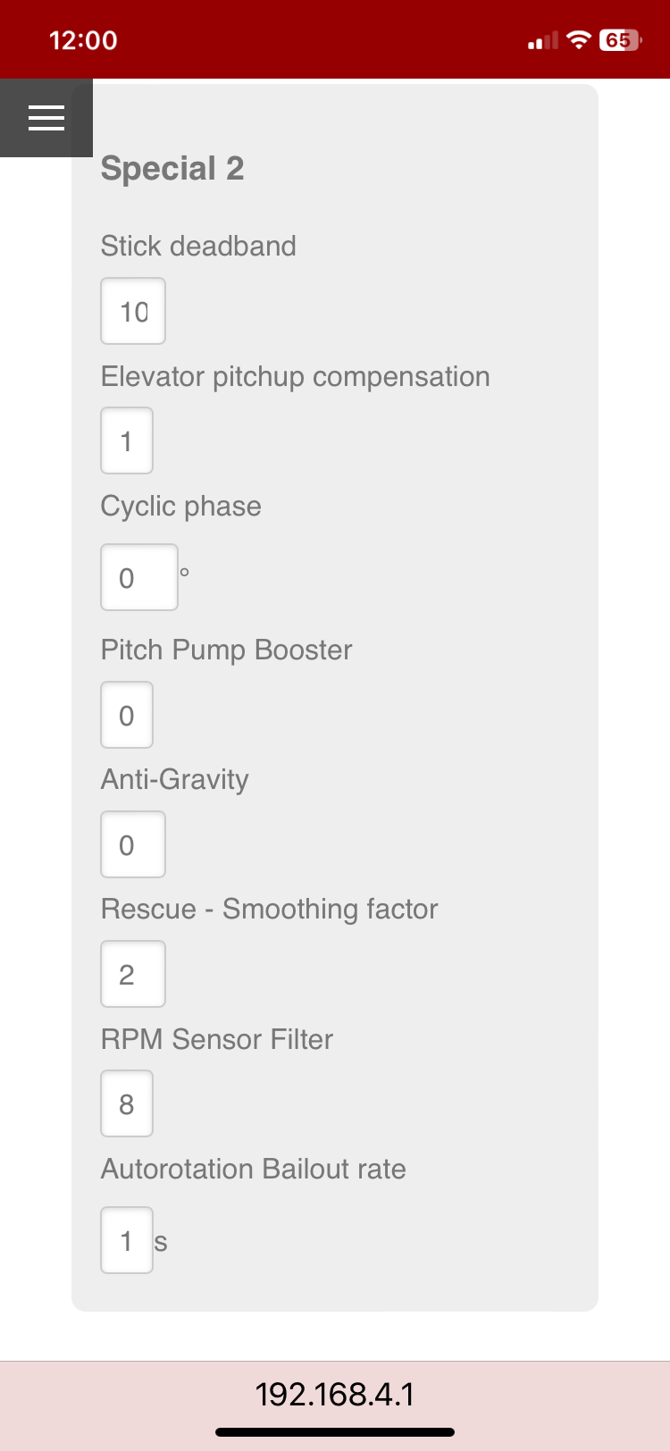

I can’t change the rescue smoothing factor using my iPhone. The other settings on the expert settings page can be changed without issue.

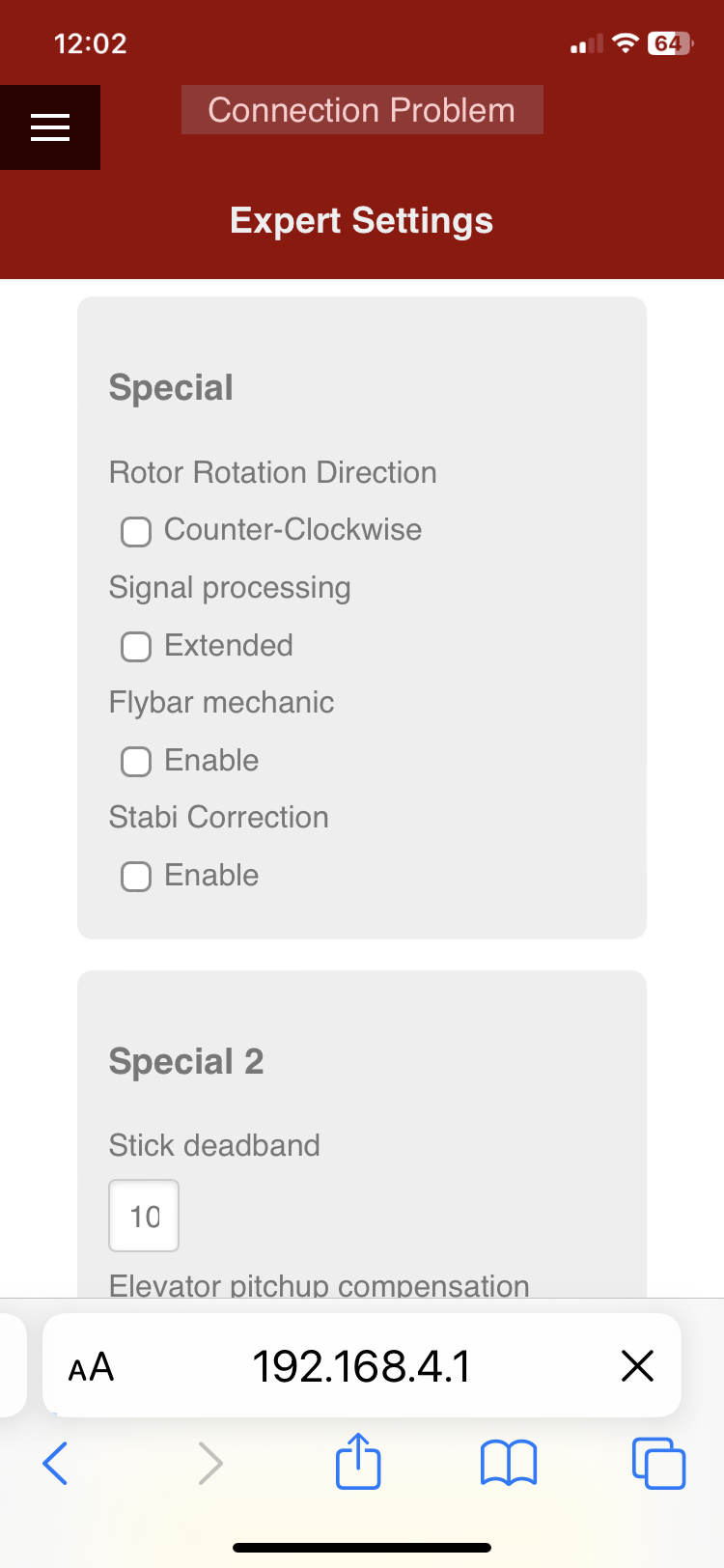

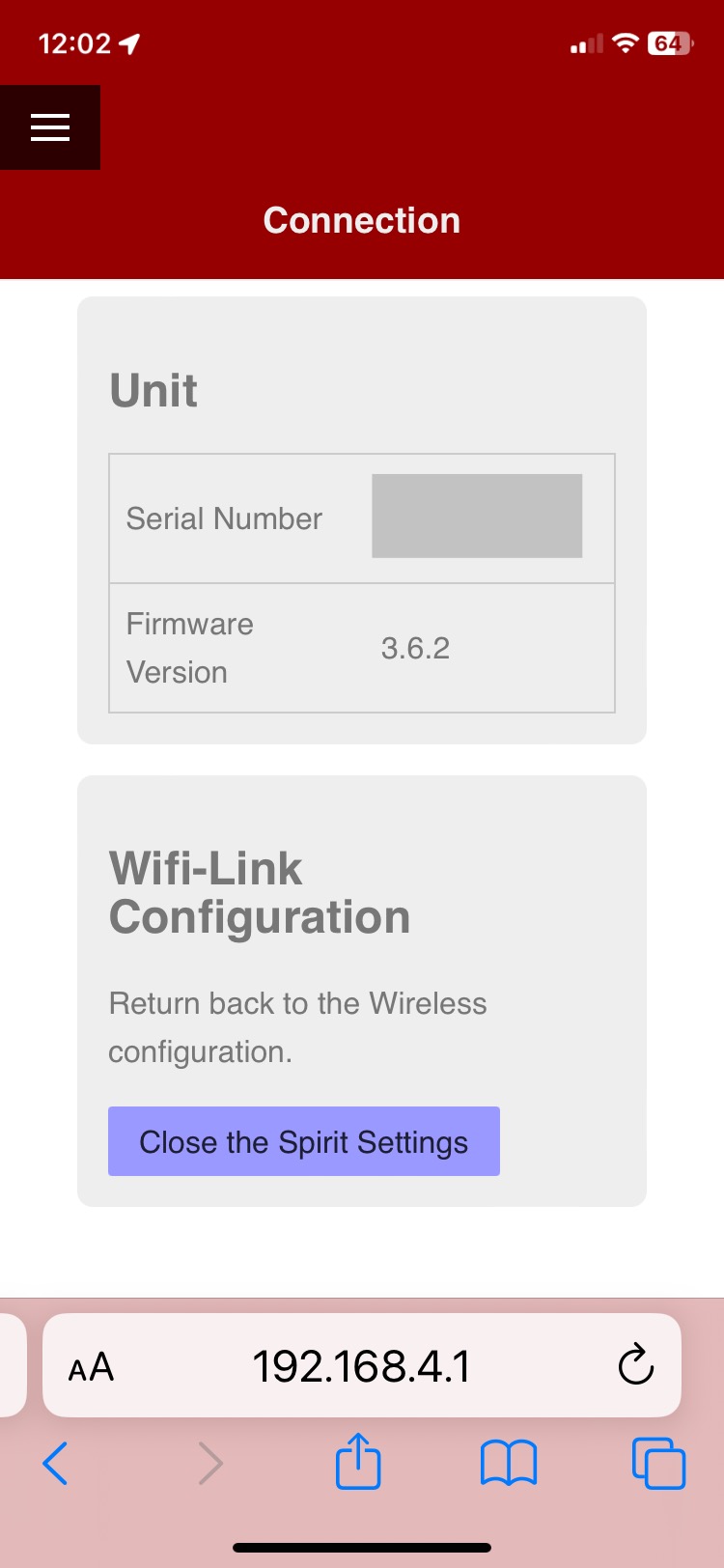

When I change the rescue smoothing factor value, the page shows it’s loading, then it shows connection problem, then returns to the connection page. Sometimes, the web page disconnects from unit while iPhone shows it’s still connected to the spirit WiFi link network.
