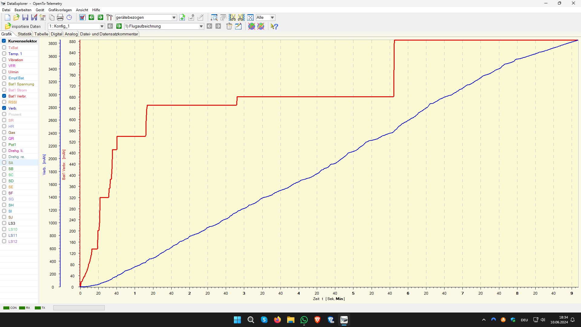

Unisense telemetry in 3.7.0 does not work correctly
STC...
Posts: 20
Joined: Sun 28. Mar 2021 10:43:14
Hardware:
Spirit 2 connected to Frsky Archer RS via F-Bus (+ and - connected to RUD and inverted S-Port to AIL)
Unisense connected to Spirit. (+ and - connected to free receiver channel and signal on left pin of SAT1)
Telemetry data is transmitted and ETHOS integration works.
but there are 2 problems:
ESC voltage: freezes after some time at 20.9V. (in several flights always at the same value)
ESC consumption: The value rises too quickly at the beginning, then becomes slower and slower. (for comparison: the blue curve is the calculated consumption via current sensor)
Logo-550-SE-FB-2024-06-09-14-31-27.csv
(315.01 KiB) Downloaded 1699 times
are you using HoTT protocol for UniSense - Spirit connection?
Or is it connected through FBUS at the BUS together with recevier?
