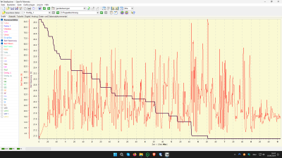

but there are 2 problems:
ESC voltage: freezes after some time at 20.9V. (in several flights always at the same value)
ESC consumption: The value rises too quickly at the beginning, then becomes slower and slower. (for comparison: the blue curve is the calculated consumption via current sensor)
