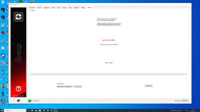

it does not work
server offline
Helihello
Posts: 12
Joined: Wed 14. Aug 2024 14:59:22
Did you try again later?

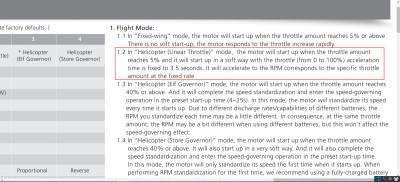

I contacted hobbywing and he answered me:
""Hi dear sir,
Please see the discription about "Helicopter (Linear Throttle)" mode, the soft start controlled by ESC can only in the first 3.5s, in case that governor external like ****, will provide 10% throttle at the beginning, which could cause a tail kick. But the governor external can take over the soft start in the first 3.5s, when the throttle curve of governor is more gently than the throttle curve of ESC.
However, after 3.5s the spool up can only be controlled by your governor external, and the ESC will respond to the governor external immediately.
So probably, you should adjust the curves and parameters of your governor external.""
only helicopter linear throttle is good (fixed wing has spoolup much faster)
for 3.5 seconds esc hobbywing command spoolup initial
but if I create a curve 0/10/60/60/60/60/60, 10 it is a lower value of 50 and the governor spirit it activates over 50.
I want to understand let's forget about the esc command for this moment, if I use a value less than 50 (10) only to start helicopter, the parameter "spoolup rate" , spoolup rampup They are active or are active only with values ​​above 50% of throttle curve?
I can create throttle curves with as many points as I want (tx16s) if I use low values (0/10/60/60/60/60/60) in theory should start slowly (after in the air i use flat curve 60/60/60/60/60)
but I can also program governor spirit to have a soft start sweeter than the esc in this case the governor spirit commands the start initial
