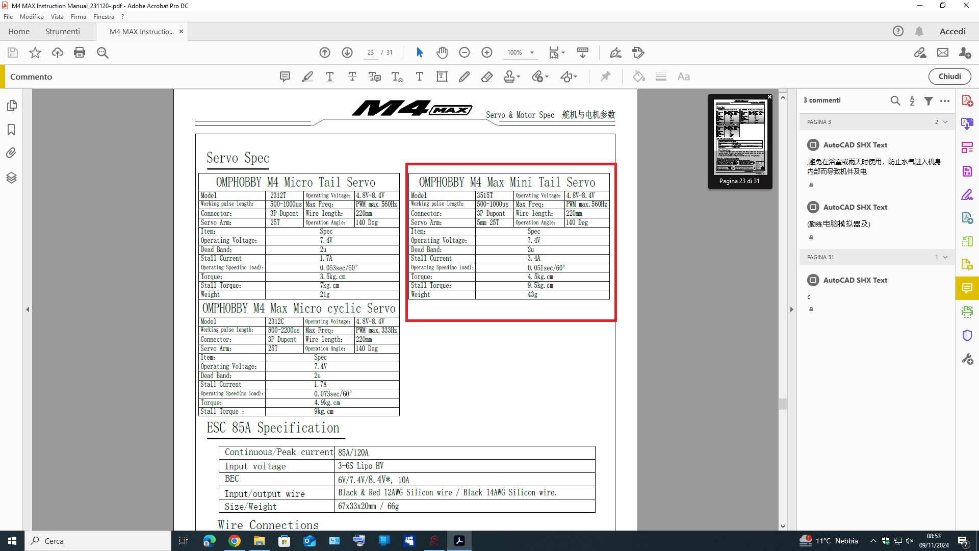

what center pulse rudder you have set in SERVOS - TYPE ?
for servo rudder 3515t is exact pulse center 760us

Hello Franz, the center is set to 760, see attached screenshot.
