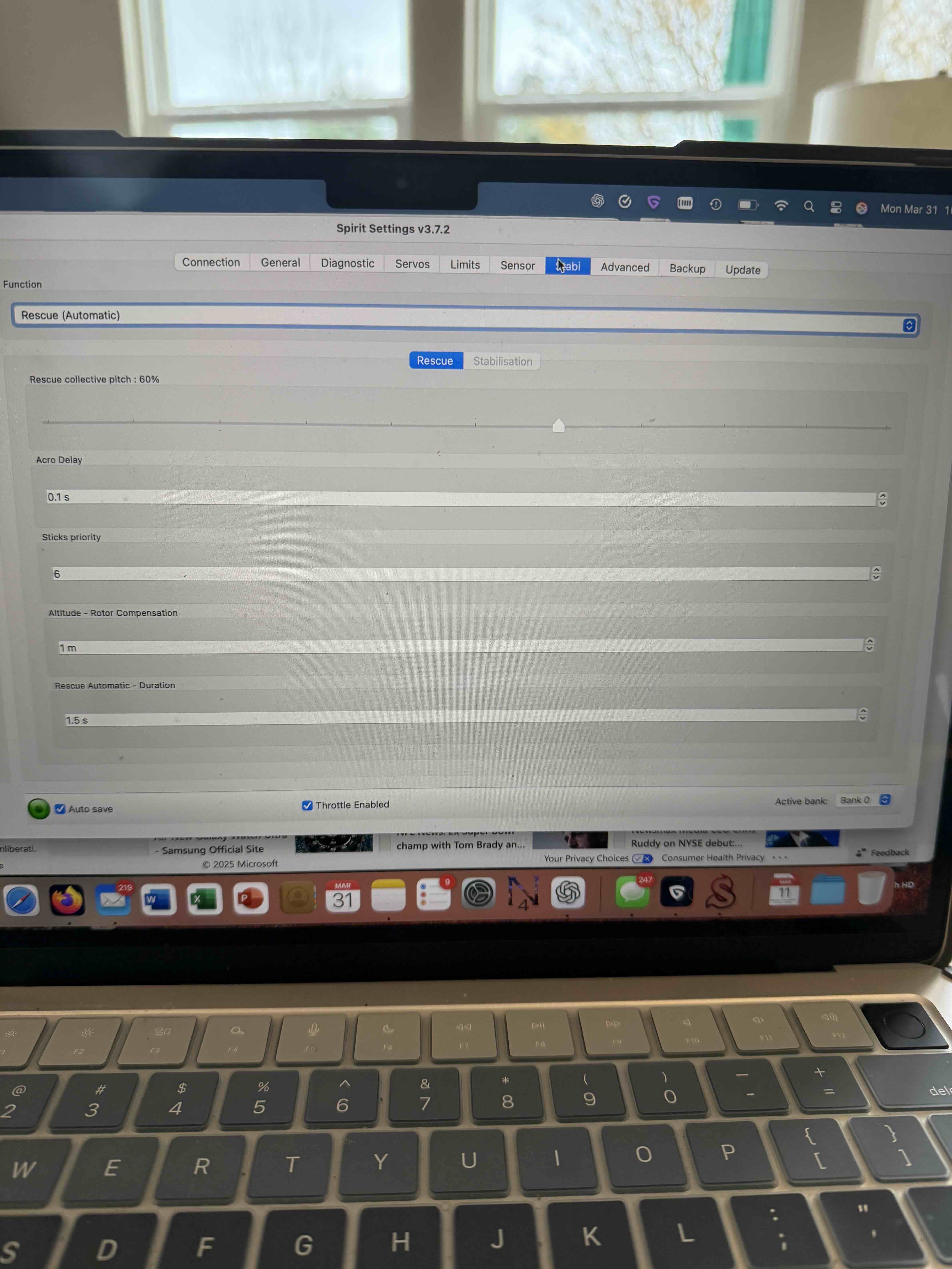

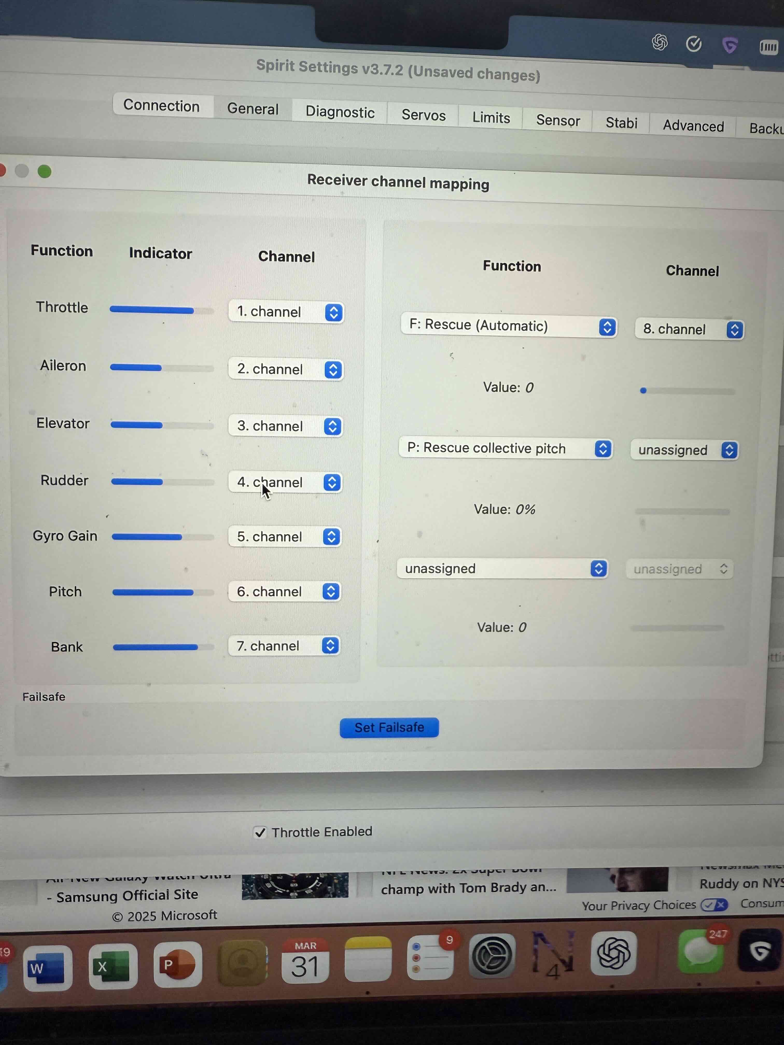

I set up a back up Jeti 900NG satellite receiver with a Rex 7 Plus as the main receiver and I cannot get auto rescue to work using channel 8 on the transmitter. It appears to conflict with channel 5, so I keep channel 5 unassigned. All the auto rescue settings are correct in the Stabilization tab in the Spirit software. Please let me know what I need to do to get it to work.

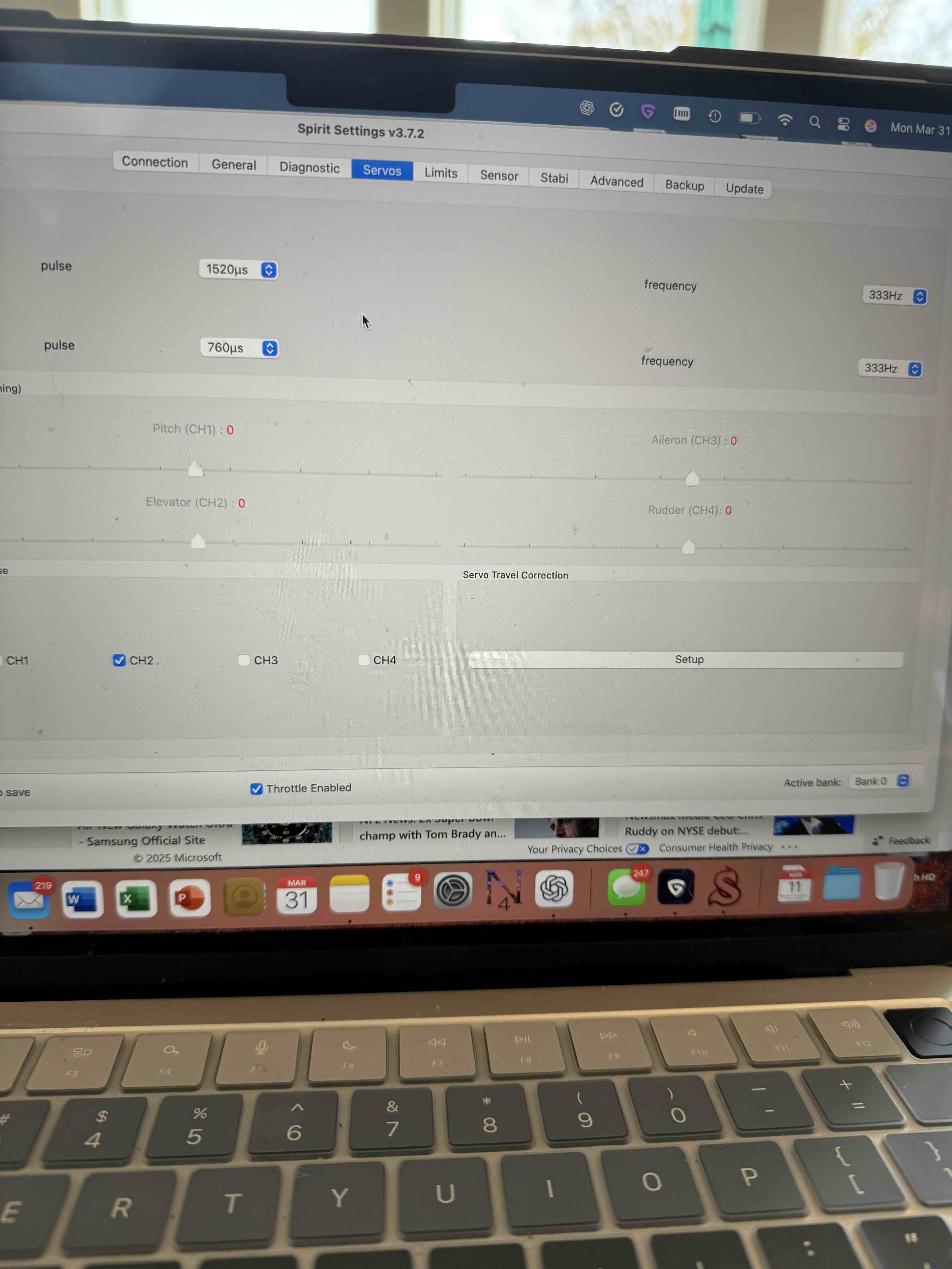

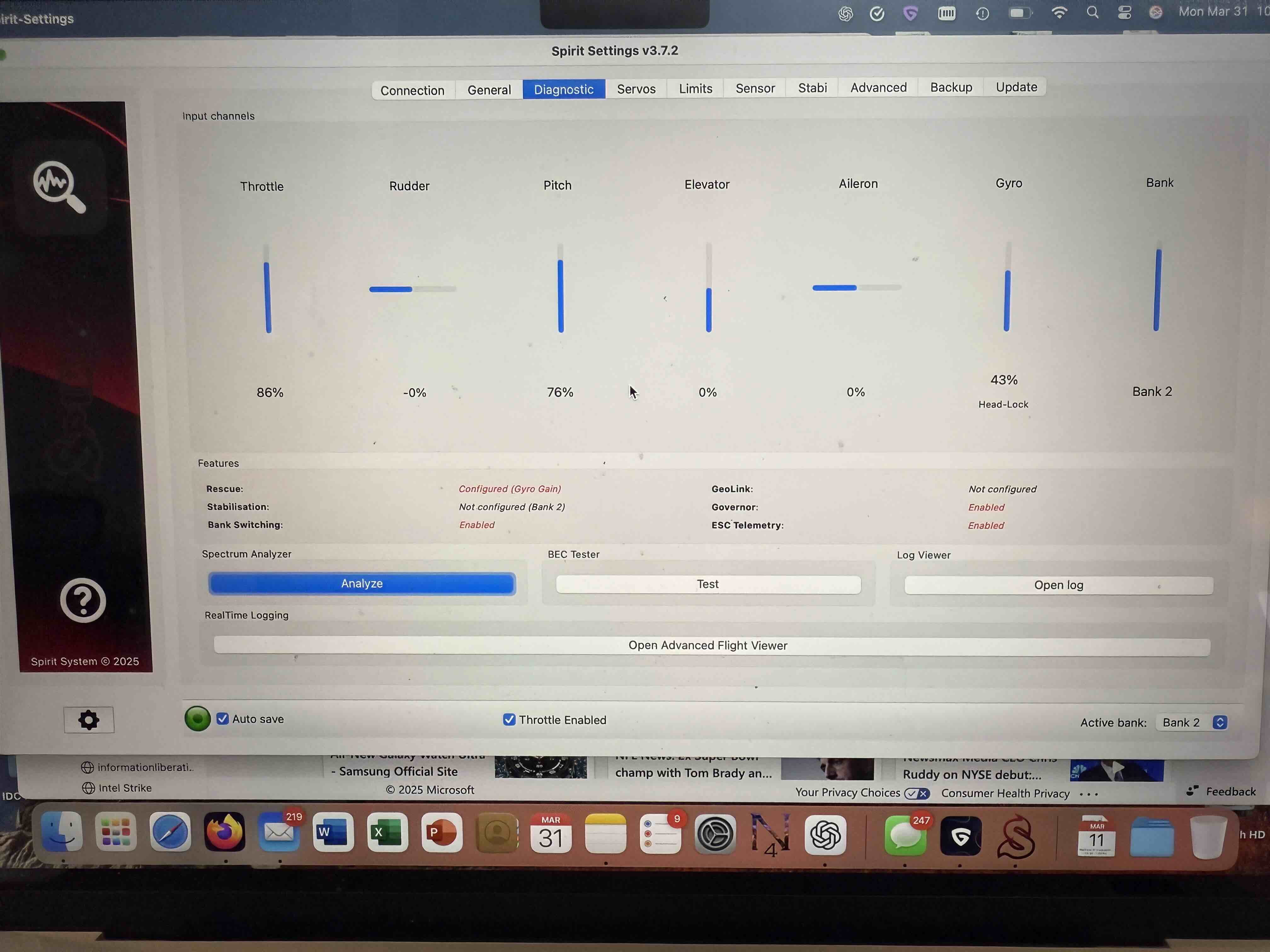

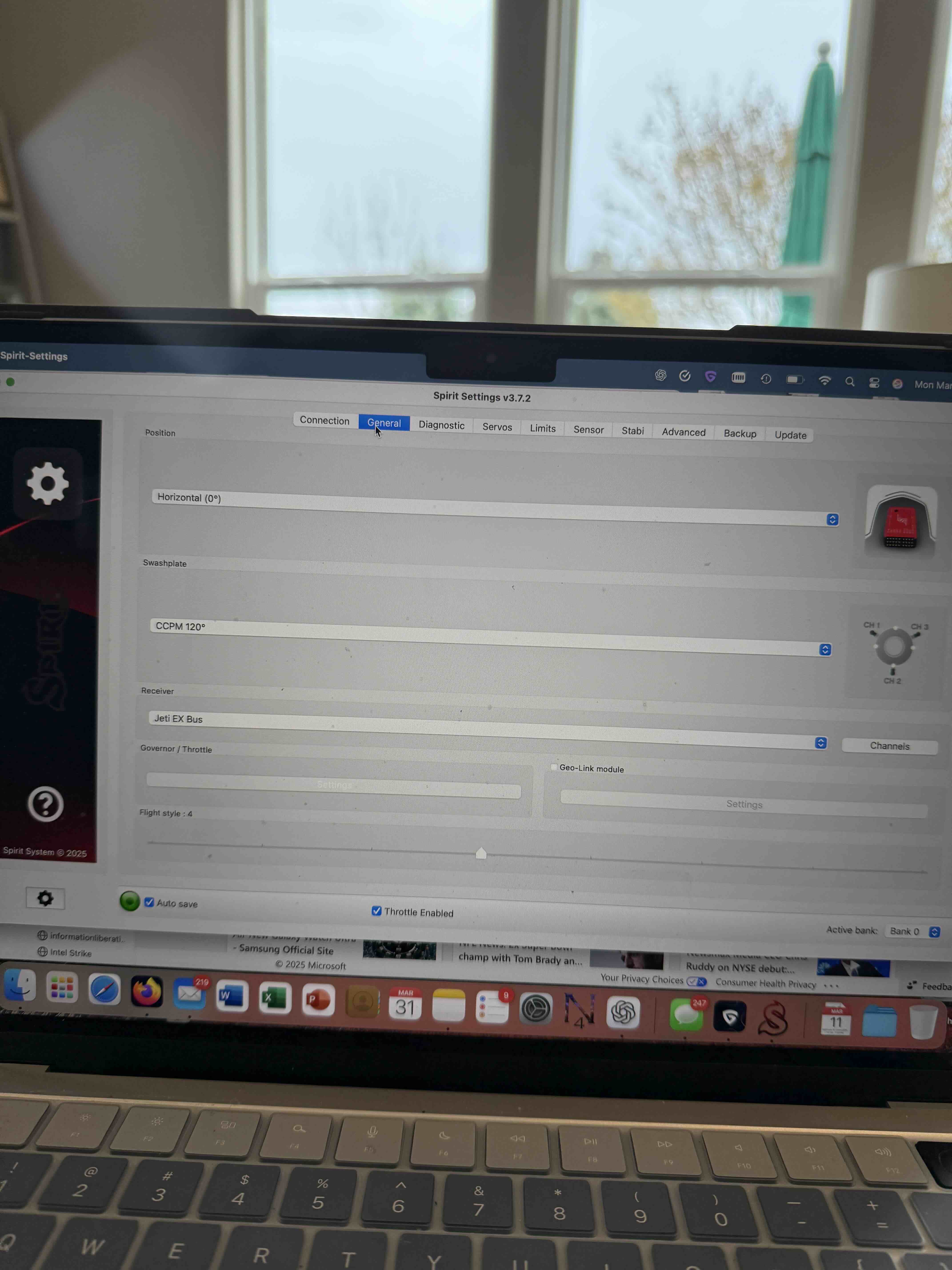

Please see attached settings to my Jeti 12 transmitter and Spirit Software

here are the rest of the screen shots

The problem is your Stabi/Function.
It should be set to: Selected by Channel.

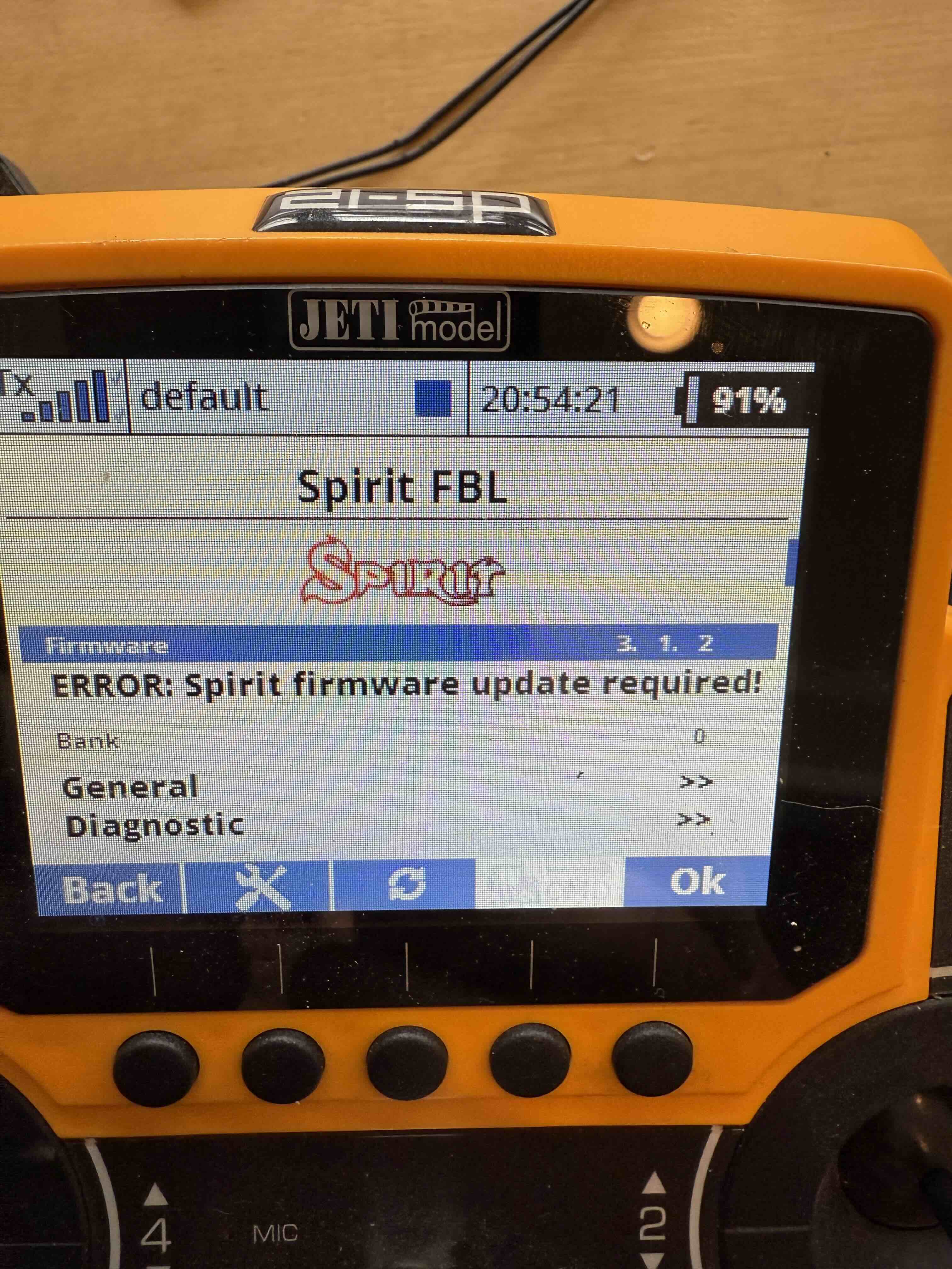

Also you have to update your JETI BIN file. This is super important, otherwise any change in the integration menu will lead to incorrect settings.

Thanks for the help/, I fixed the update in the Jeti 12 transmitter and the Select by channel worked for the Stabli function.

krm97 wrote:Given that it is select by channel, how does it determine which rescue function one wants to use, like Auto Bailout via altitude function?
By channel :)
Select by channel means you can assign its own channel to each stabilization function and use them seperately or even simultaneously. In your case you have channel 8 = F: Rescue (Automatic), so that's what it controls.
