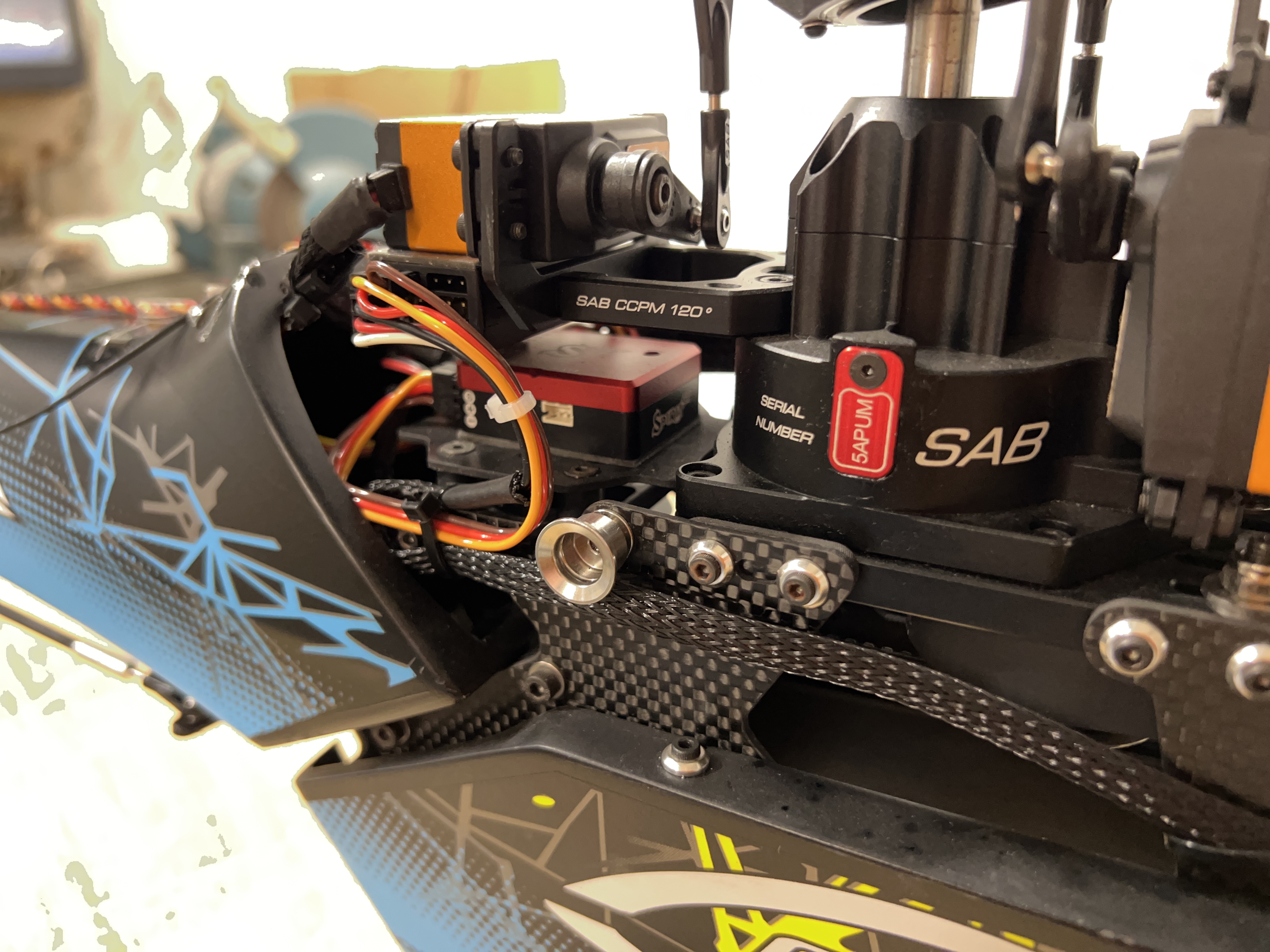

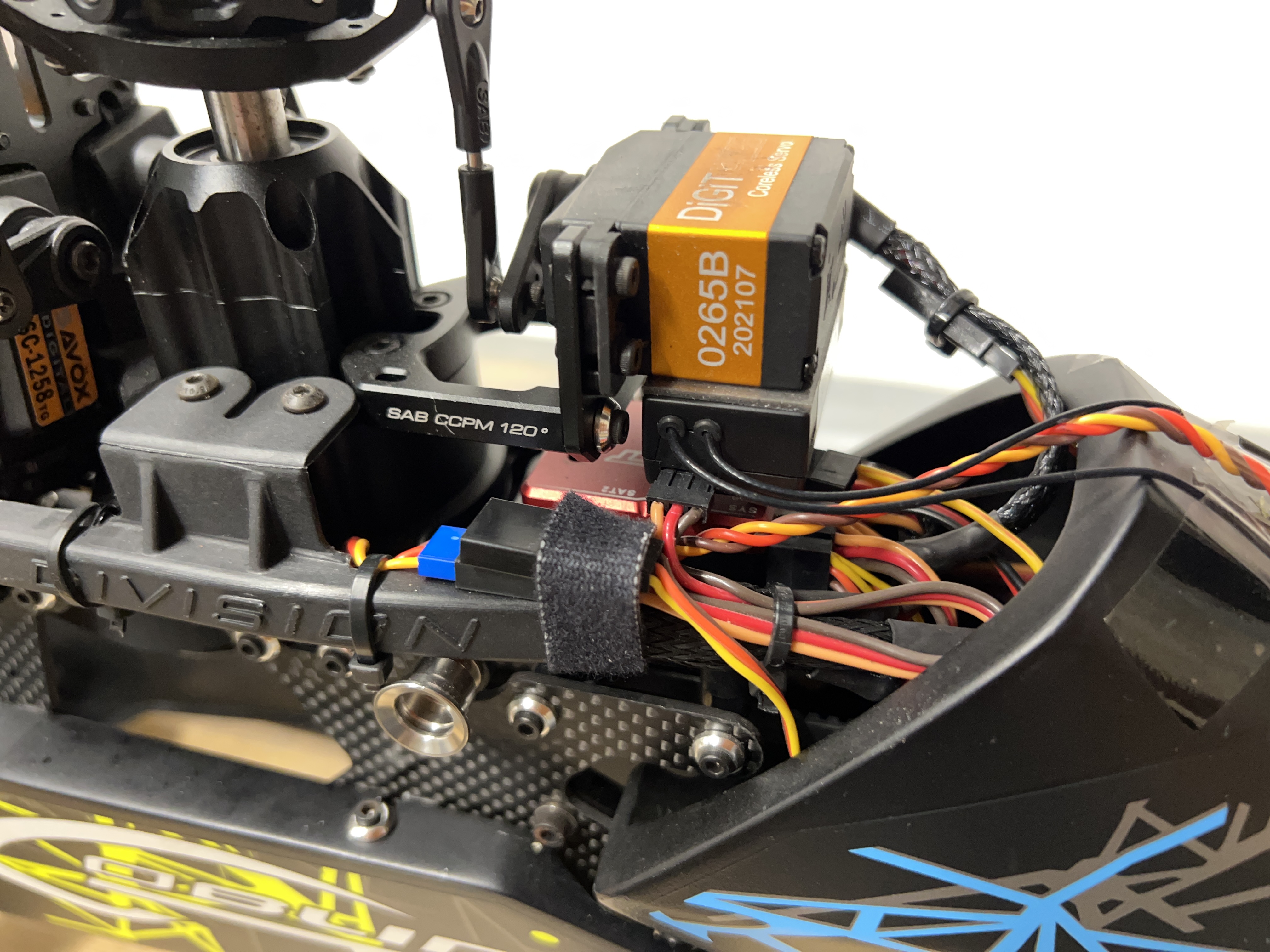

I'm wondering which part could be responsible. I found a post in the forum that states that the Spirit GT's altitude sensor is always used to determine altitude, not the Geolink's altitude sensor, nor the GPS data.
Is this still the case?
Could my setup in the helicopter play a role, where the Spirit GT is directly below the receiver, which in turn is directly below a swashplate servo?
I'll upload some pictures for illustration.

But if you connect one extend USB and connect software (outside with all geolink satellites) and raises and lowers the helicopter with your hands the barometer and laser reading of the geolink it's precise?
my reading barometer It is accurate to within 10 centimeters.

And how do you read the height? (On the table without blade, use a USB extension cable)
