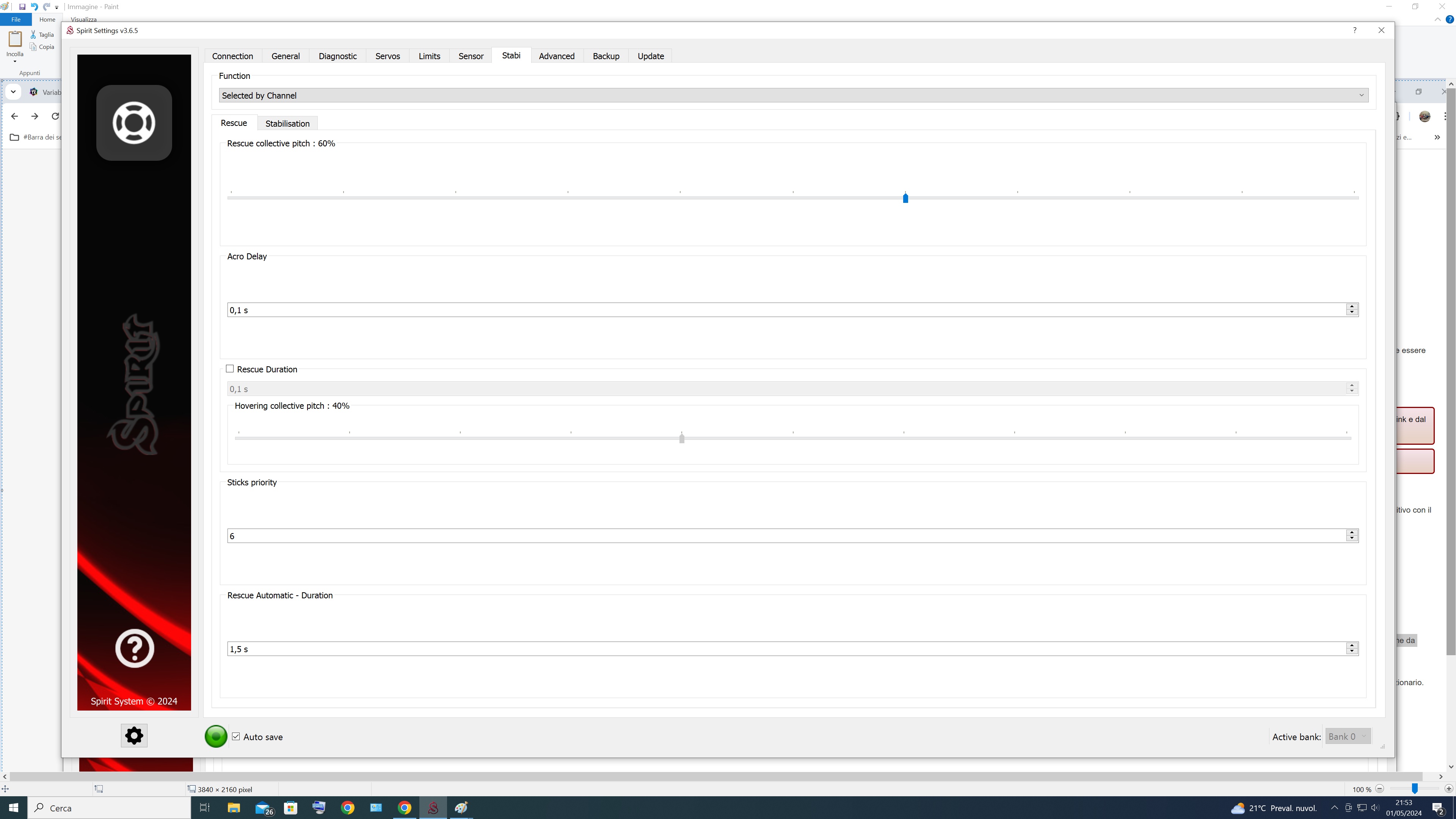

zexx86 I'm activating rescue normal, rescue automatic and return to home on spirit gt
In acro delay is found 0,1s
in this very short time I don't believe it that can be turned the helicopter with inverted flight.
I think it's necessary 1 second or a little less to reverse helicopter.
then the acro delay parameter do I have to move it?
should I increase this value?and what value should I enter?
with translation from English to Italian I'm not clear on this parameter.
I'm waiting for your answer
Posts: 630
I think this value is depended on how fast your rotation rate is - if you have 360°/s then the acro delay can be maximum 0,5 s to turn from inverted to normal and then the rescue will be activated -
If you give here 0,1 s you will only get your maximum rotationrate so my opinion -
Maybe Tomas can confirm that - but I'm pretty sure that's the case.
