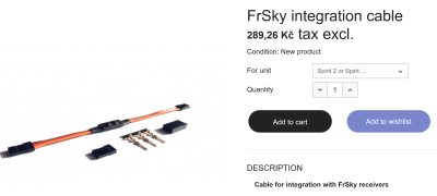

Alexander my FrSky-Integration cable has before changeing (adding the additional plug) also two black connectors -
In the online-shop the integrationcable is also with two black connectors
If it will not work then maybe the purchase of a new one is necessary, then it should work -

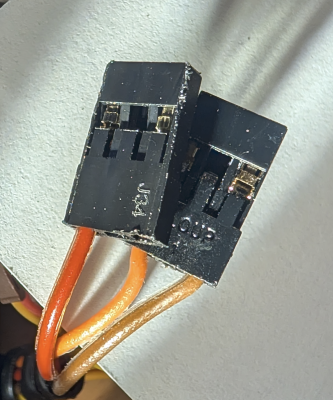

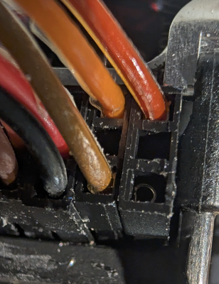

Can you take a photo of the modified cable/wiring please?

here the pics of the modification and how they are plugged in:
As mentioned before, with this connection the ESC does not arm.

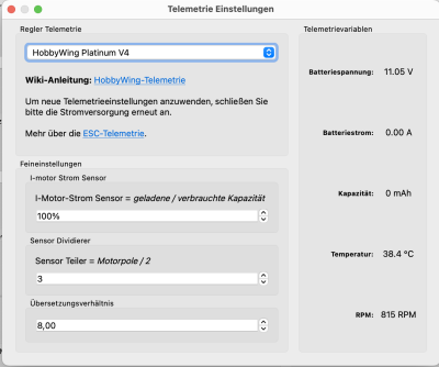

In the settings telemetry window, the values provided by the ESC are displayed, but unfortunately not on the transmitter.
In the settings software HobbyWing V4 is selected, Kontronik ESC is selected in the transmitter and for testing Hobbywing ESC was also selected, neither of which shows anything.

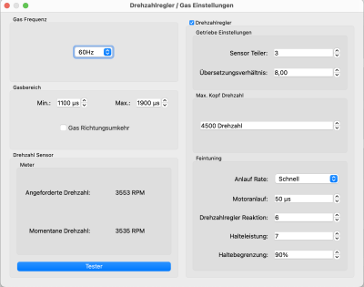

Also still noticeable is the different RPMs displayed at some point between 2600 and 2700 RPM, when suddenly a lower value is displayed in the telemetry window, see screenshots.

I’m using a Spirit GT which requires a different connection than yours, but I have the same issue you’re having with the RPM value shown in the Spirit Settings Telemetry page, but the RPM readings shown in the Futaba Tx telemetry are correct though.

BTW, the RPM shown in the Spirit Settings Telemetry Tab are fine up to about 1,200 rpm’s. Then, they drop to varying three hundreds figures.

If you have noticed that in your case it is displayed correctly up to 1200 RPM, in my case up to about 2600, then it seems to be a calculation error of the sensor value, possibly related to the number of poles.
However, if this behavior only occurs in the telemetry window, then I could live with it.
Now the values shown in the governor window would only have to be received correctly by the TX, then I would be satisfied. Unfortunately, the TX does not receive any data.
