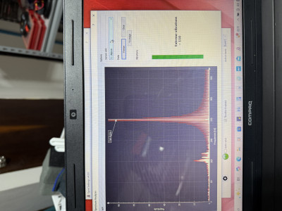

Instead of flying this new model with the vibrations detected by the Spectrum Analyzer, I started systematic approach to isolate the vibrations, as suggested by Senaka.
I disconnected the main belt to run the motor and pulley only, and this is what I got.
Seems the next thing to do is to test with another motor.
Vibrations running the motor and pulley only.

Installed another motor from a heli which has OK vibrations in all axes and at all head speeds, running the motor disengaged to have equal testing conditions.
Was surprising to find the TB70 showed the same vibrations pattern as with the original motor.
Conclusion:
The vibrations detected in the TB70 are inherent.
Let see how the model does in actual flight.
