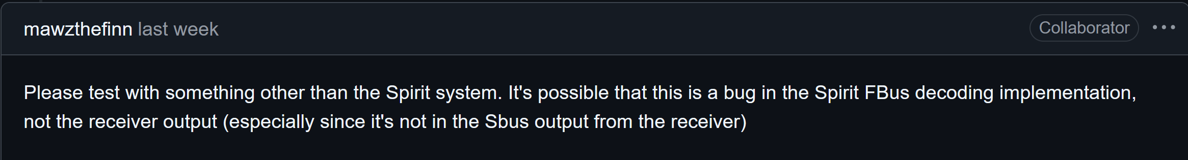

@ ZeXx86 (Tomas):
I don't know if this is allowed, but I would like to post the developers' idea on Github here and ask you, Tomas, to test whether this could be a possible source of error. If you can rule this out, preferably with a plot, then we might have the opportunity to initiate something with FrSky if this is their fault. It is in my personal interest to have an excellent FBL (Spirit) that works reliably. Thanks in advance ! BR Matthias

Posts: 12782
We were able to reproduce the issue. It was happening also with previous firmware versions and is really related to a higher channels. We are checking what is causing the problem.
