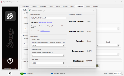

Just installed a Hobbywing Platinum 40A V4 connected to a Spirit 3 connected to FrSky. Telemetry works as it should, however it doesn't show any current figures when spooled up, i.e. it stays at 0 amps for some reason, so I checked the Spirit 3 locally when spooled up but no joy; any ideas?

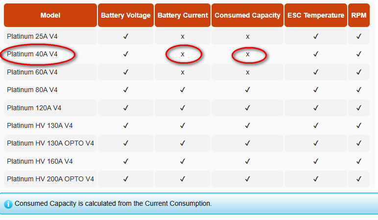

Posts: 1068
mainstreet
Posts: 13
Joined: Mon 10. Jul 2023 16:40:41
Oops, cheers!
