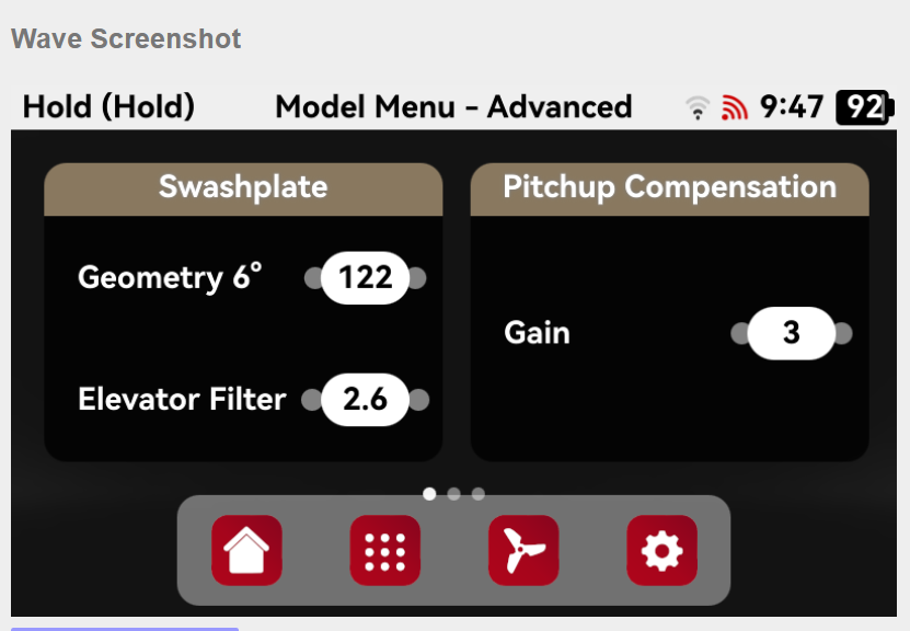

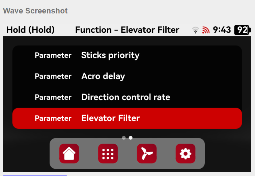

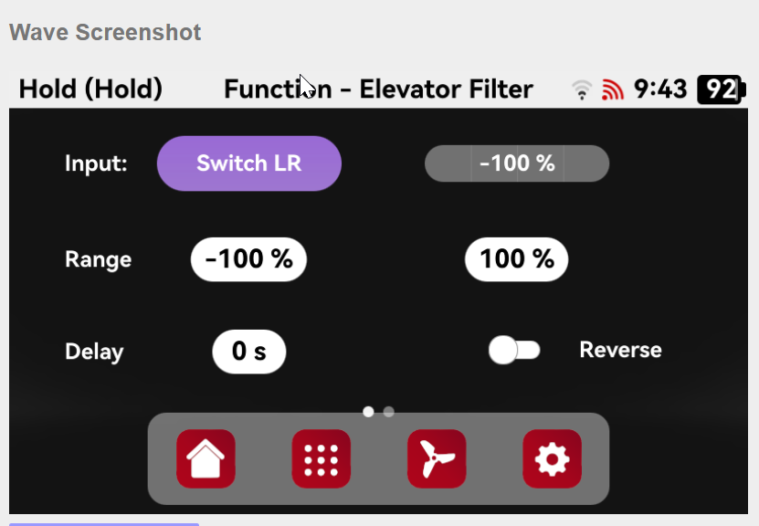

I just figured out that I can assign parameters to a switch via the Function menu—that’s exactly what I’ve been looking for! Unfortunately, I can’t get it to work.
I went to the Function menu and set the input to the LR switch. By swiping left, I assigned a parameter—for instance, the elevator filter. After repowering the system, I monitored the parameter in the Advanced menu, but when I flip the LR switch, the parameter value doesn’t change.
Could it be that I didn’t adjust the range properly?
