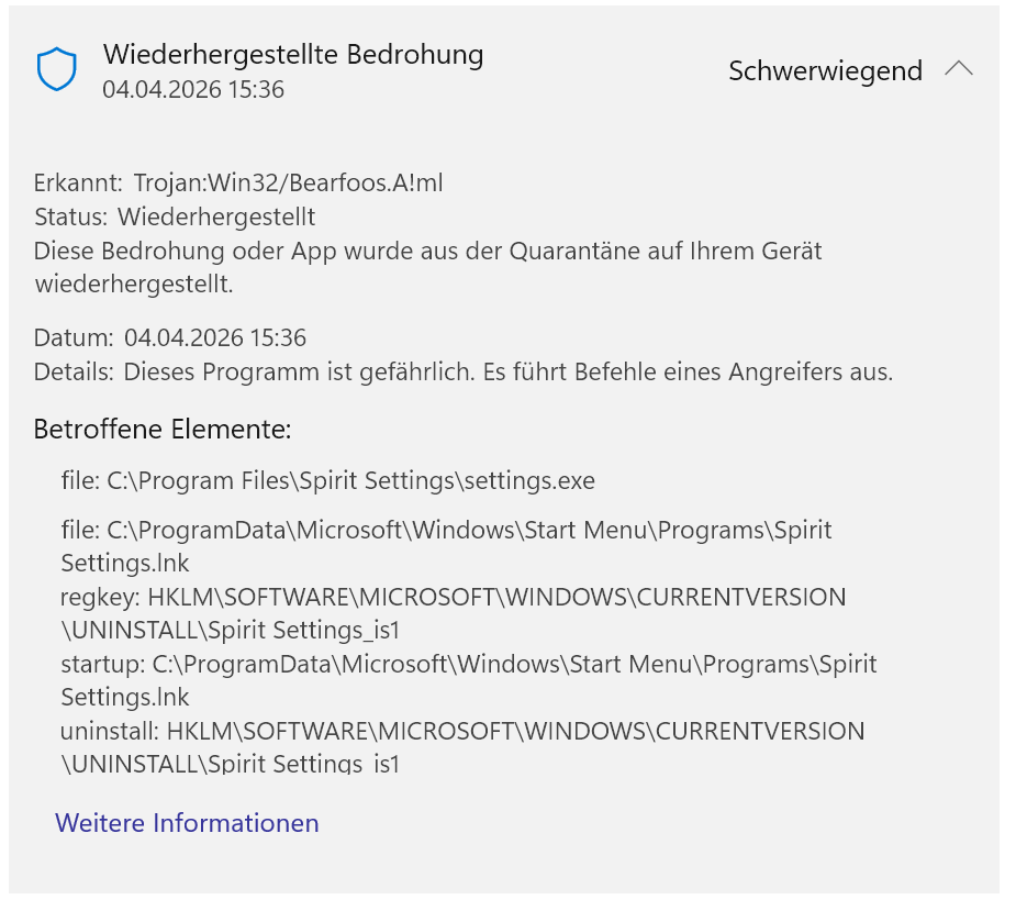

Furthermore, Windows Defender is flagging the software as containing a Trojan; see the attached file.

Windows Defender issue unfortunately happened many times before and there is no good way of resolving it. Their algorithms are not working correctly.
To be sure you can use online virus scanners and check it by over 80 other antivirus programs. You should see that only Defender will likely mark it incorrectly.
