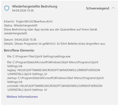

I'm having an issue with the latest Spirit Settings software version 4.0.3 on Windows 11 25H2. As soon as I open the Diagnostics tab, the program simply closes without displaying an error message. However, I've been experiencing this problem ever since that small 3D model was added to the Diagnostics section. In older versions, I was able to work around this by minimizing the window until the model was no longer visible. Unfortunately, this workaround no longer works with the current version. So it seems to have something to do with the display of this mini model.
Furthermore, Windows Defender is flagging the software as containing a Trojan; see the attached file.
Any suggestions on how I can fix this issue? My graphics card is a Power Color Red Devil RX 6600XT, and I’m using the latest driver.

Windows Defender issue unfortunately happened many times before and there is no good way of resolving it. Their algorithms are not working correctly.
To be sure you can use online virus scanners and check it by over 80 other antivirus programs. You should see that only Defender will likely mark it incorrectly.
