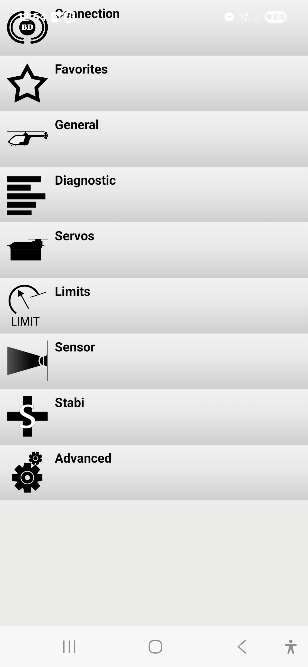

There's not much info I can tell you. The main menu page opens up OK (as per attached screenshot) like normal, but after about 10 seconds, it just shuts down & I get a pop-up box saying "Spirit Settings keeps stopping". My phone's Device Care function also reports that Spirit Settings is crashing frequently.
