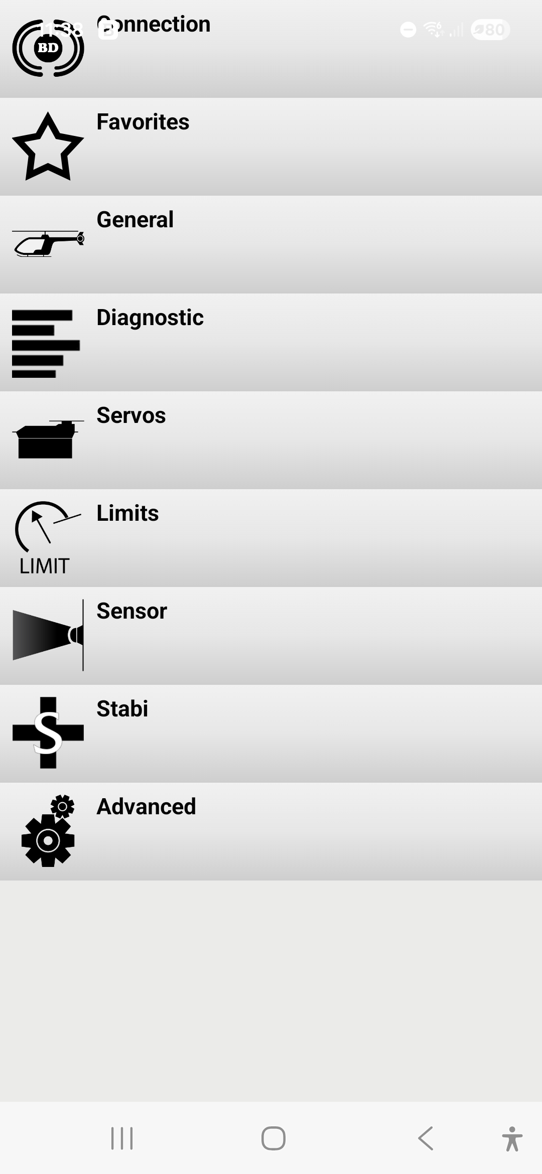

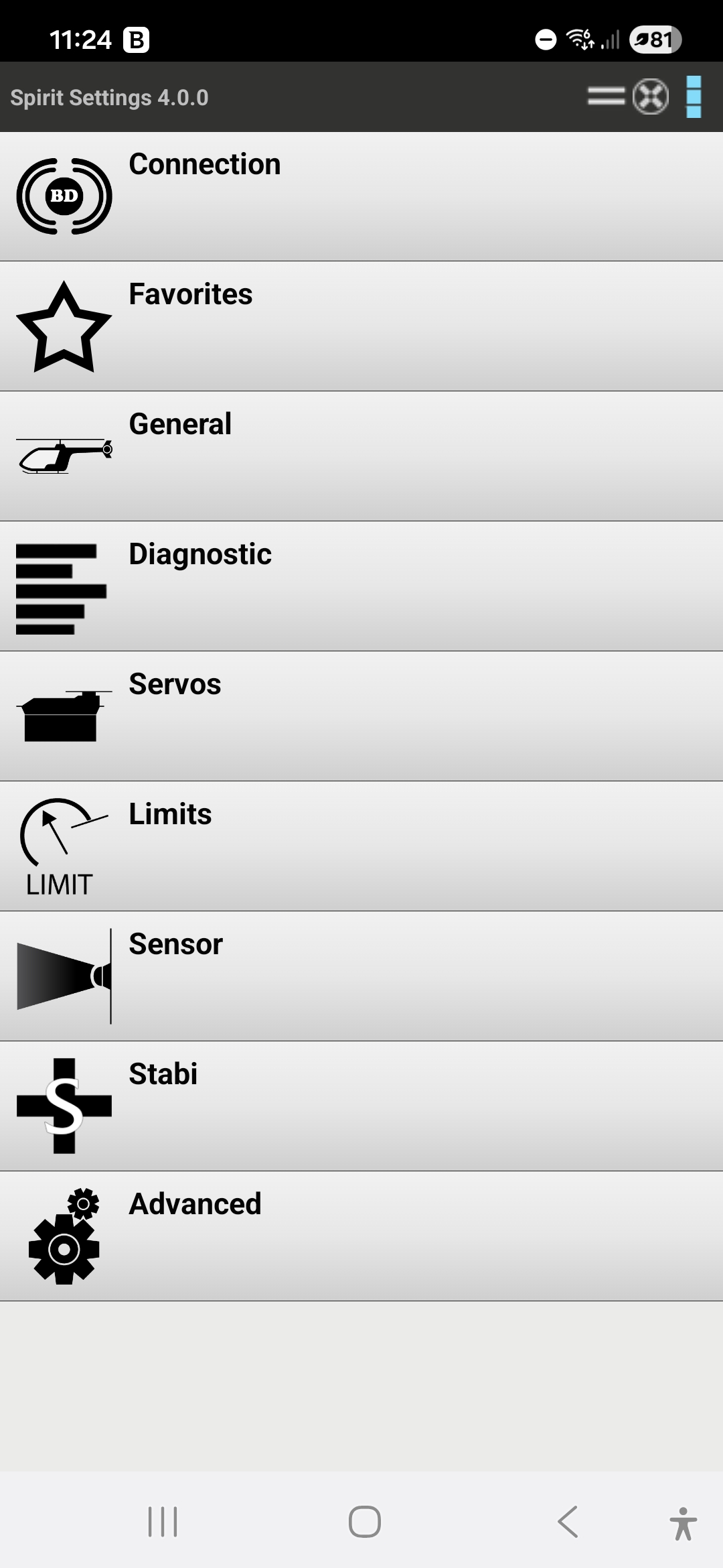

Firstly, for the 4.0.3r3 app, the initial main menu page is moved upwards so that the Connection menu tab is over the phone's status icons. You cannot see the app version & other icons like on the 4.0.0r3 app. Screenshots are attached to show what I mean.

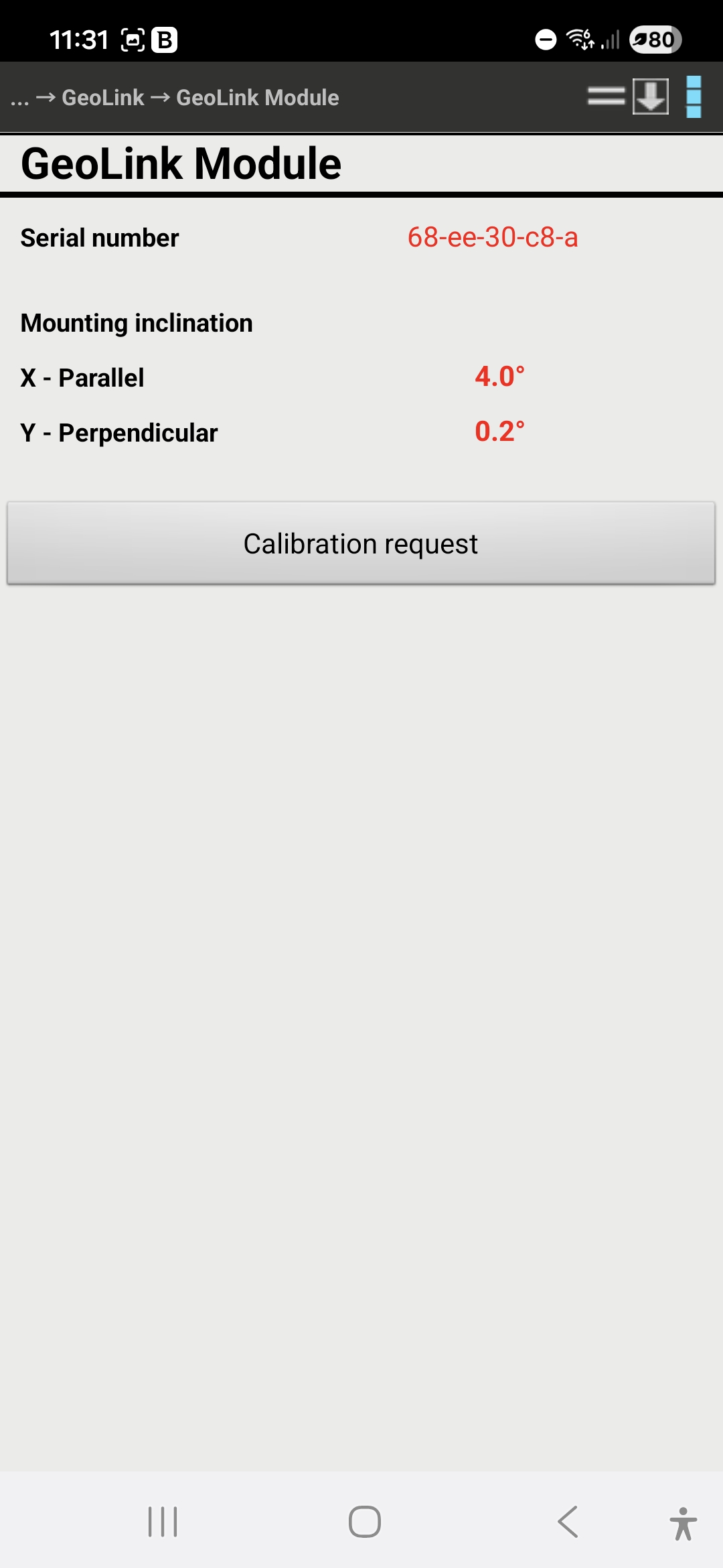

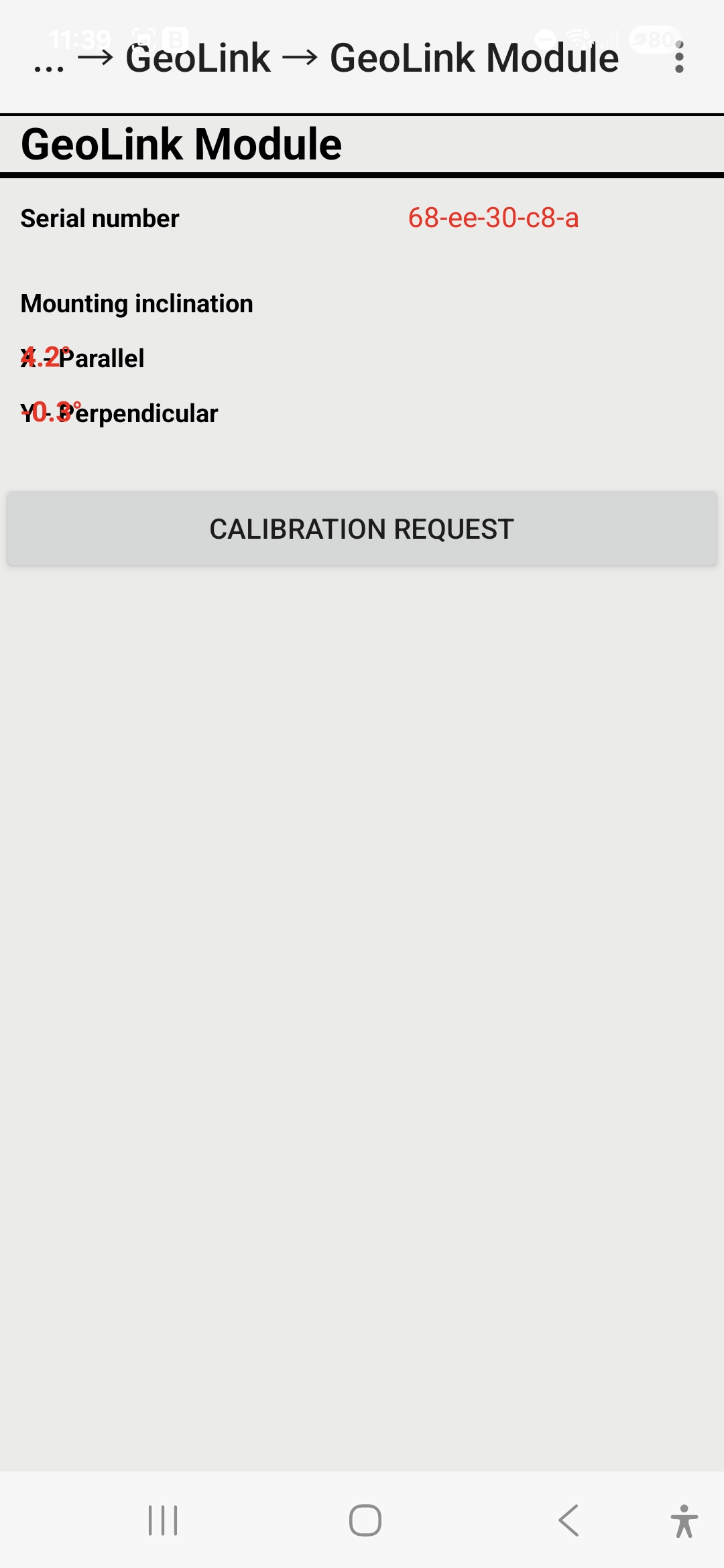

Secondly, in the Geo-link module information of the 4.0.3r3 app, the inclination angles appear on the left & are masked by the headers. Screenshots also attached (as there is a maximum of 3 attachments, I will add the 4th in a new message).
