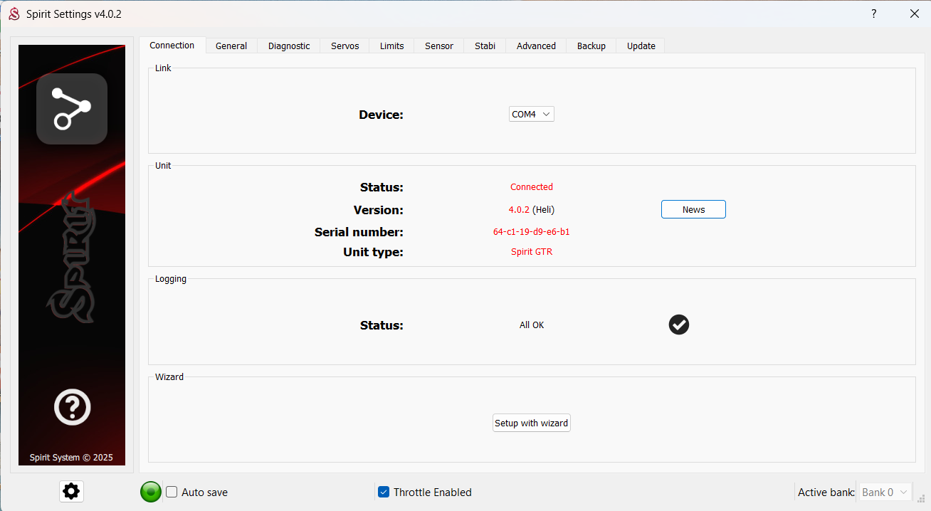

Hi, serial number of my GTR is "64-c1-19-d9-e6-b1" Inform me when available on Spirit settings. Should I re install Spirit settings with an earlier version or keep v4.0.2 ?
Thanks for your help
