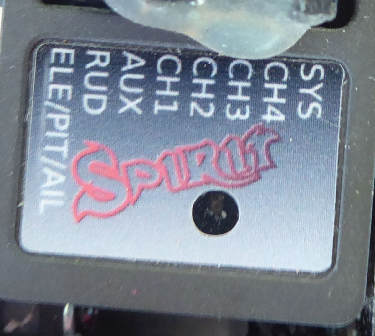

I am trying to get this unit to bind to a Gen1 Spektrum DX8 with no success. This was a working flyable machine but has stood idle for a few years.
The DX8 is on DSM2 only and the Spirit is using a satellite receiver.
The bind process appears to complete, steady orange light on the satellite and the Spirit briefly moves the cyclic servos on startup but will accept no control inputs from the the DX8.
Does anyone know if a usb lead was provided with these early units as I'd like to check to see whether it is set internally for DSM2? I don't remember having one.
All that was in the box apart from jump leads and sticky pads (I'm the original owner btw) was a bluetooth module with two JR style flying leads.
Thanks.
