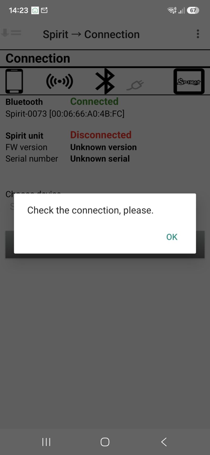

I've had some progress.
I've downloaded the 'Spirit Settings' Android App from Google Play.
Managed to pair the phone with the bluetooth adapter, but get a connection error each time.
I'm picking up power (red/brown) lead from the RUD channel as I'm using a BEC.
The other lead is (red/orange) on the SYS channel with orange on the outer (signal pin).
I don't know if this is a software compatibility issue or something else. It does briefly say 'receiving data' but then just drops back to 'connection error'.
delta peak
Posts: 24
Joined: Sun 10. Sep 2017 21:52:01
Based on your explanation, I assume the red/orange cable is plugged wrong. The orange cable has to point to the label.
