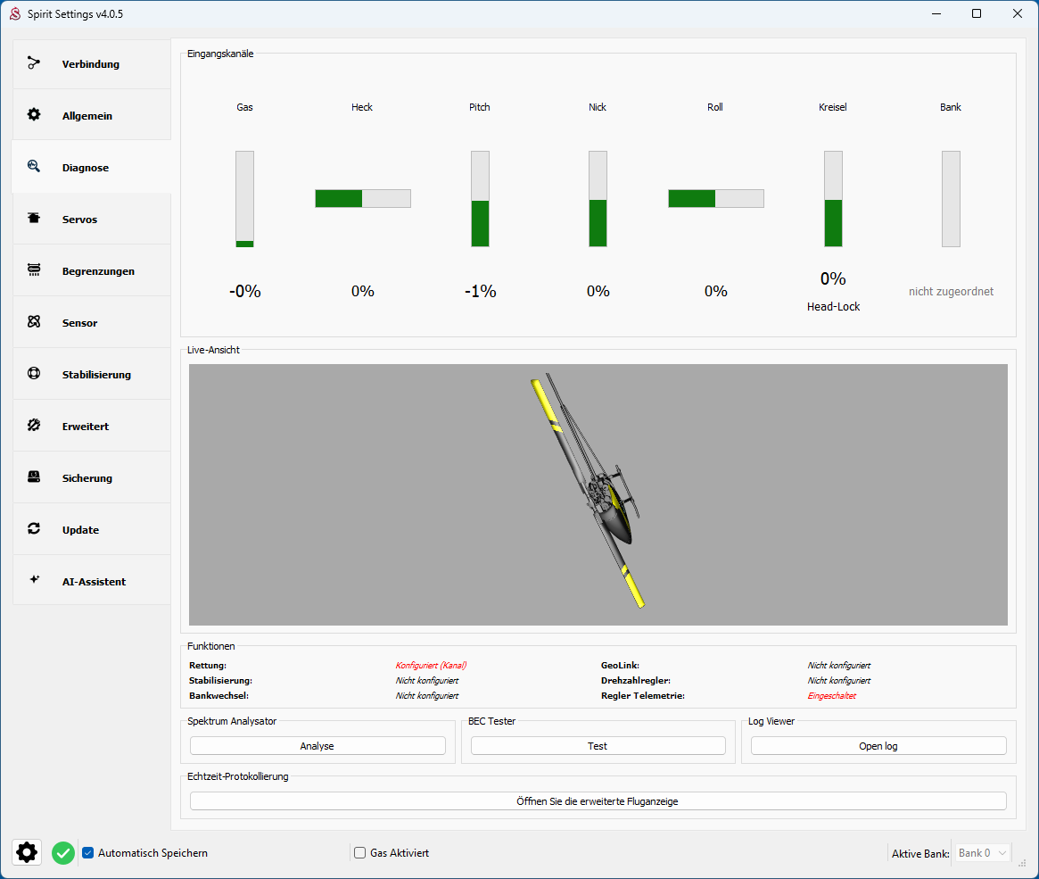

I did the following test today:
- I uninstalled the Spirit unit from the heli, connected it to the settings software and applied a small battery.
- Then I opened the diagnostics tab with the live view.
- I adjusted the unit on the table to have a definite position while starting the unit and the settings all.
- Then I threw the unit into the air, trying to do as many spins as possible (with the battery attached).
After a couple of throws, the live view was completely disoriented.
See the screenshot, which shows the unit lying properly adjusted in the initial position.
I repeated the same test with a brand new W3 and was not able to get it disoriented.
My guess is, that the sensor of this unit is not working properly.
Posts: 13090
This is very good finding. For sure we will replace this W3, it is clear that something is wrong with the unit.
