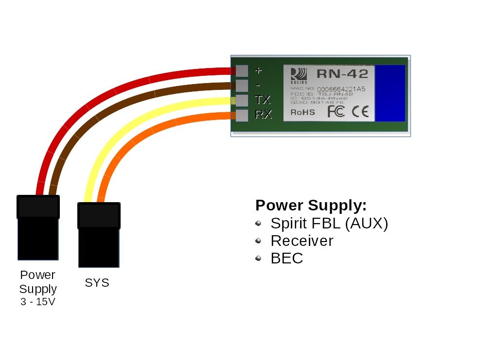

Is there anyway to power the BT Unit from the FBL itself or does it require an additional BEC?
On my larger heli's it is no issue, but for my Gaui X3 I just use the BEC on the ESC so it has only one power lead.
pkotatko
Posts: 889
In SYS port is NOT a power supply. That means, BT unit need some power connection. Somewhere on board. But, don`t let the BT unit run during the flight. Better to switch it off. Just to be safe.

Finally BT scheme in the attachement :)
