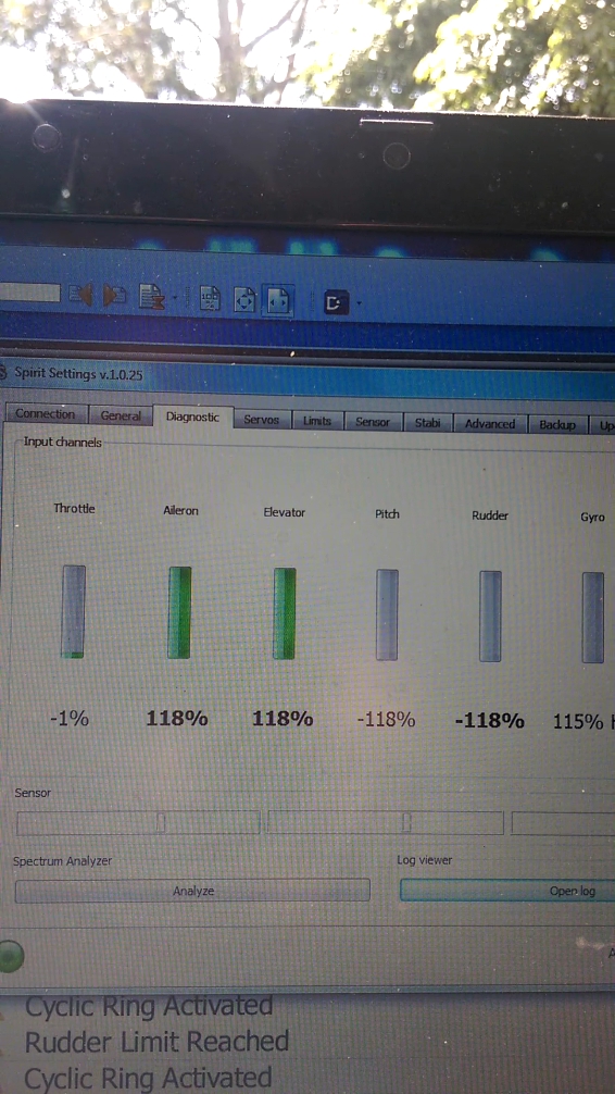

I was reviewing the video & noticed something.
When the tail is twitching, the diag screen is reporting 118's as the value.
I'll see if I can get a screenshot.
Got it from the video..
