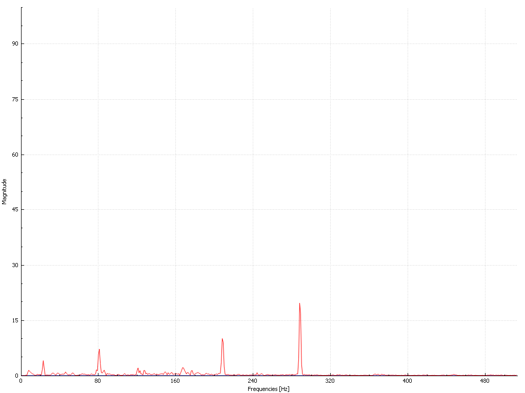

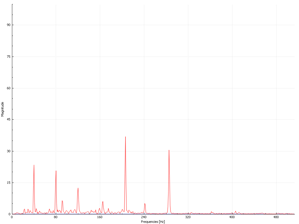

At home I did some vibs analizations again.
Initially I have really low vibs (total 11 and one peak of max 20).
After some minutes vibs are higher (total 25 and peaks below 45) - but in an acceptable range I think.
The only explanation could be that vibs are much higher during flights.
The problem is I can't test level of vibes with blades on the heli and flying.
Do you think vibs level on the bench are still too high?

Posts: 13038
I think vibrations are in normal level from attached graphs.
