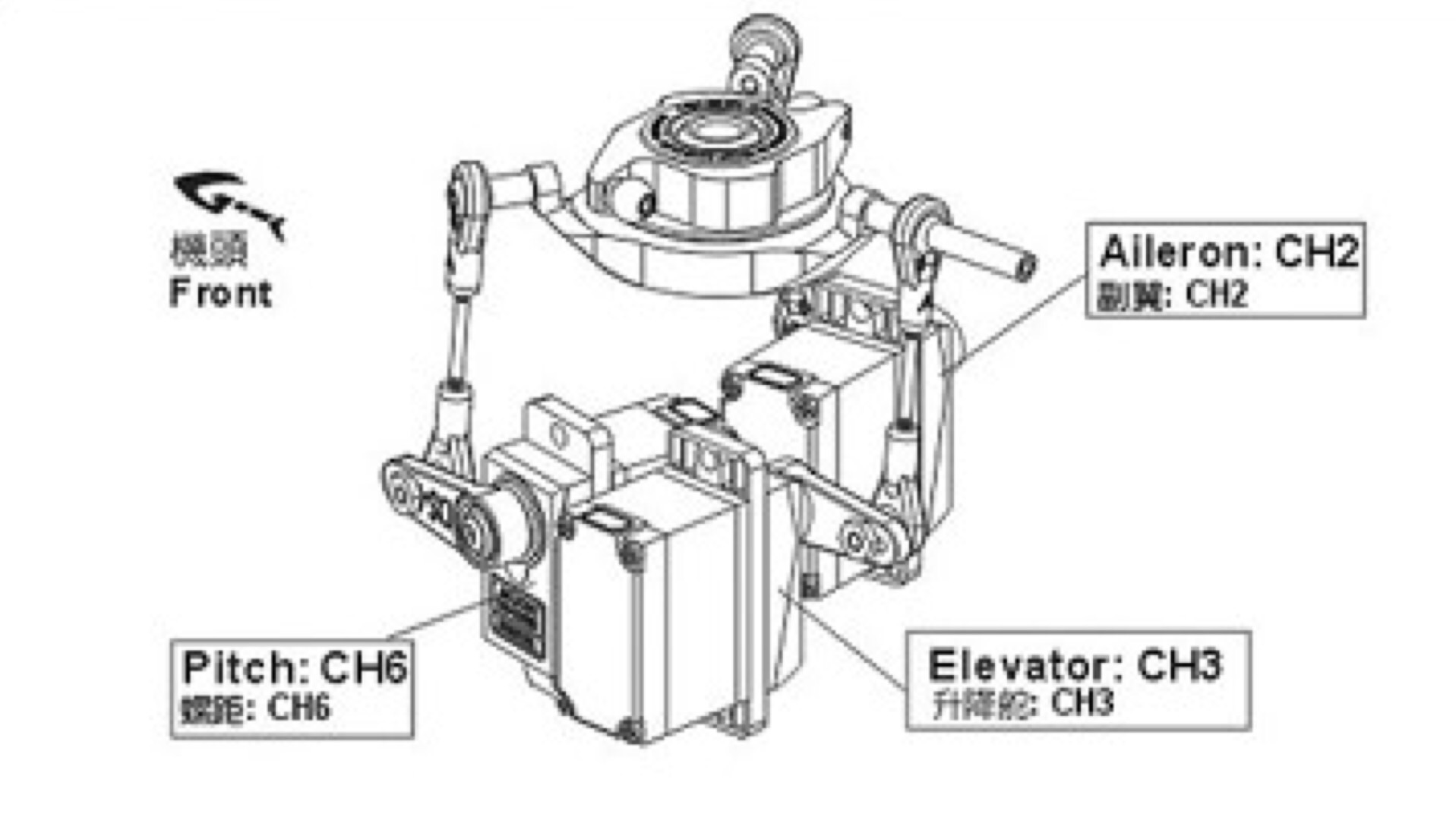

I am fitting the spirit to an Align Heli, their naming convention is.
Elev servo at rear
Pitch on left front
Ail on right front
Is this the same definition as your manual for aileron/pitch servo? Does the spirit actually care about which is the ail or pitch servo?

for Spirit, it is:
CH1 - Aileron
CH2 - Elevator
CH3 - Pitch
But in Spirit, you can even swap Aileron/Pitch to achieve minimum reversing - so it can be little bit easier in initial settings.
If you have some troubles you can ask me anytime.

Thanks for the reply it good to know that the spirit allows swap of the pit and aileron.
