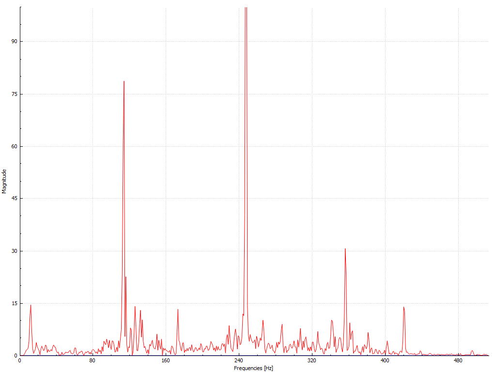

Hi
I made another analisis with tail blade and the result attached.
can you help me to find the problem?
thanks
It seems that vibrations are coming from the tail (the highest spike).
Second, lower spike, is coming probably from the autorotation gear.
This level is very, very high, so I do not recommend to fly with it until resolved.
First from all, if spike is not that high without tail blades, then it is possible that they are unbalanced, or problem is even in tail grips or tail shaft. So I recommend to unmount these parts step by step and check always how it affect vibrations.
If you will notice big difference, then you probably found the problem.

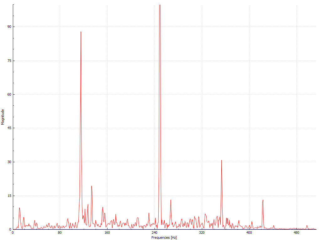

Hi
I flew the heli with this graphs and for my, flyes Ok, i am not an expert, so maybe is not so good, but I do not know.
Rescue works great too....
the only thing that i need help is in the tail wag at idle up 2 that is 90% flat curve.
In normal and at 75% goes fine, but in 90% start to wag.
thank you
I am afraid, but with 90% vibrations are most probably even higher that it is in mechanical limits of the helicopter to work correctly.
These vibrations may even unscrew all screws, so you have to be very carefull with each flight.
