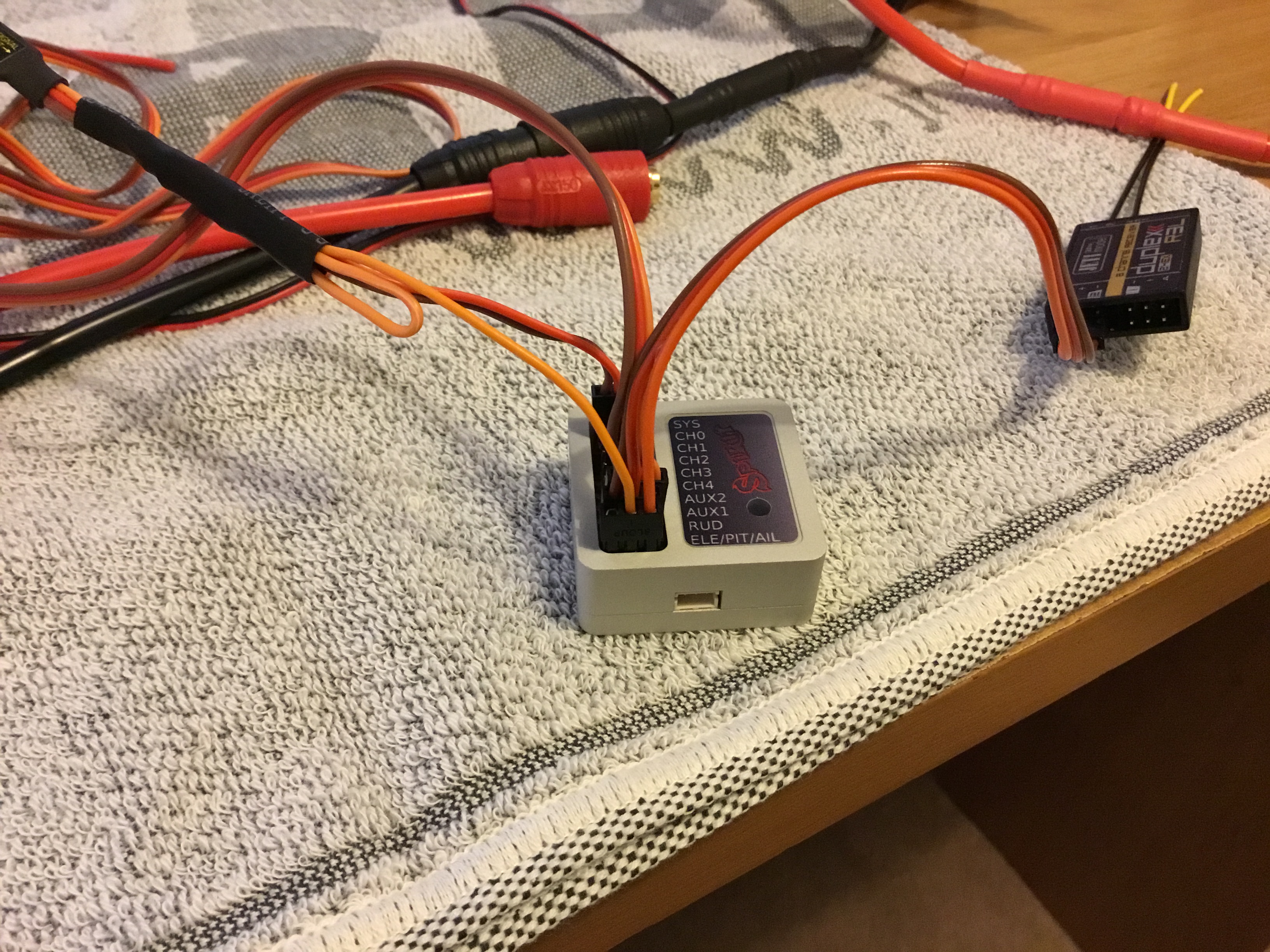

Opto cable has been modifed as per VBar diagram using two 2K resistors.
However I can not get any RPM data to be displayed in the Spirit software.
Signal wire from the sensor cable is connected to the middle Pitch pin and a plug with the + & - is connected to CH0 on the Spirit Pro.
So basically about half an hour to make the cable up and about 5 hours trying to get it to work.
Any ideas please?

You only get readings shown in the spirit app when the governor is enabled AND the throttle valuenis above 50% (the governor is engaged).
I had a call for a feauture to show the actual reading of the rpm's everytime but until now these is not implemented.

When throttle hold is deactivated I see the requested RPM, no problem but nothing at all in the current RPM tab.
Also nothing displayed on my Jeti DS16 transmitter.
Straight line curve of 70% in the transmitter.
No mention of anything Governor related in the flight log.
Governor is enabled in the software and external governor mode has been enabled in the ESC.
Posts: 12921
I can't see anything wrong with your current setup. It looks good.
I have something you can try to verify if the signal is changing.
I will send you a PM.
Posts: 12921
As far as Marc1 tested, the governor is reading the RPM with unmodified Opto cable. So no mod is needed, except for the servo connector.
