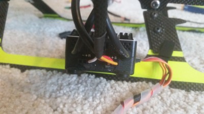

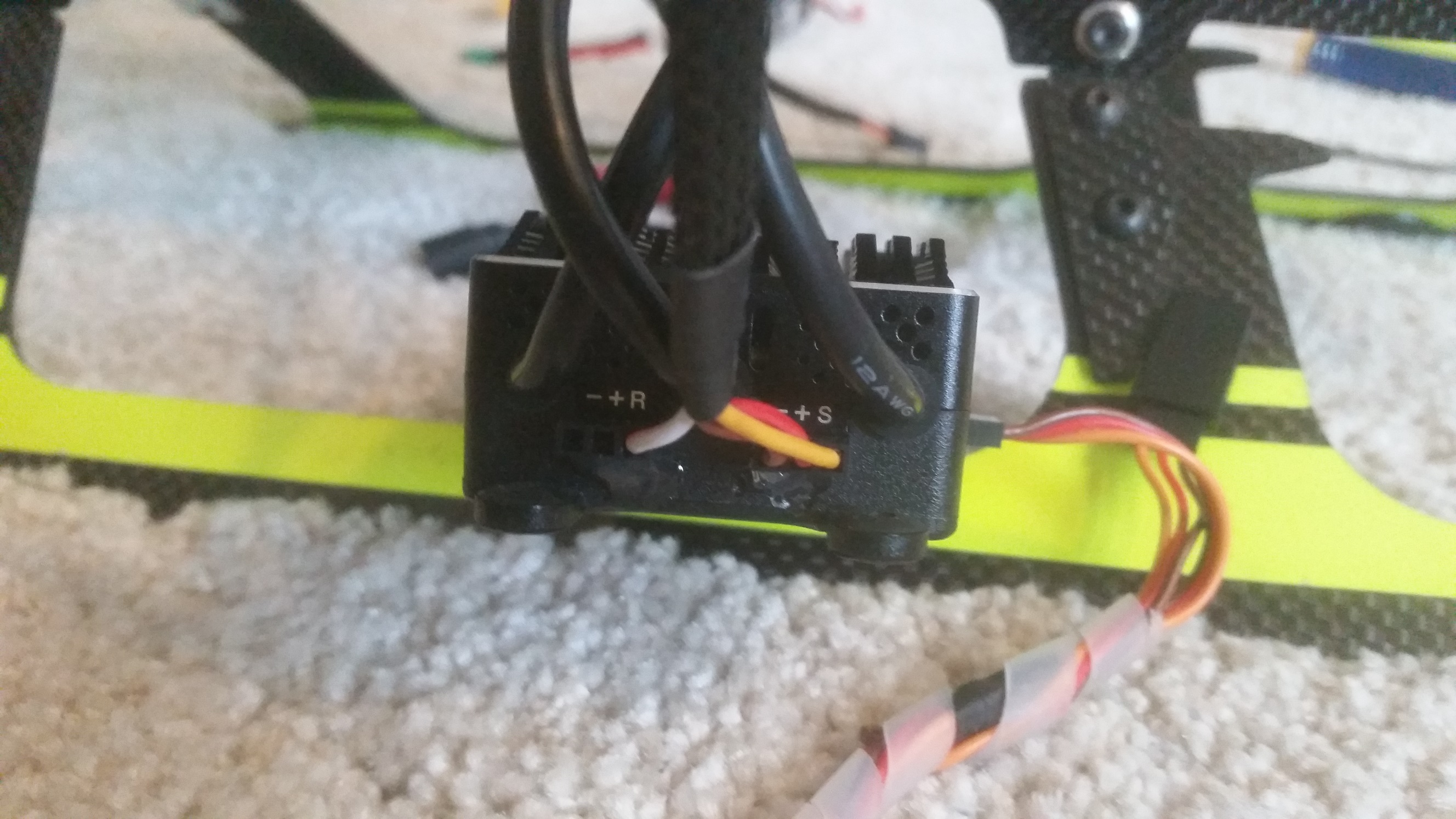

You can take a photo of the connection, maybe it is somewhere there.
Posts: 13047
I am sorry, I have checked the manual from this ESC and it seems that the RED wire (from Throttle cable) is actually required for powering part of the electronics inside the ESC.
So this is very likely the problem.
This ESC can't process the signal without this as it rely on the BEC/battery voltage.

Readding the red wire to the ESC throttle signal cable solved the issue. Many thanks @ZeXx86! Motor spools up nicely.

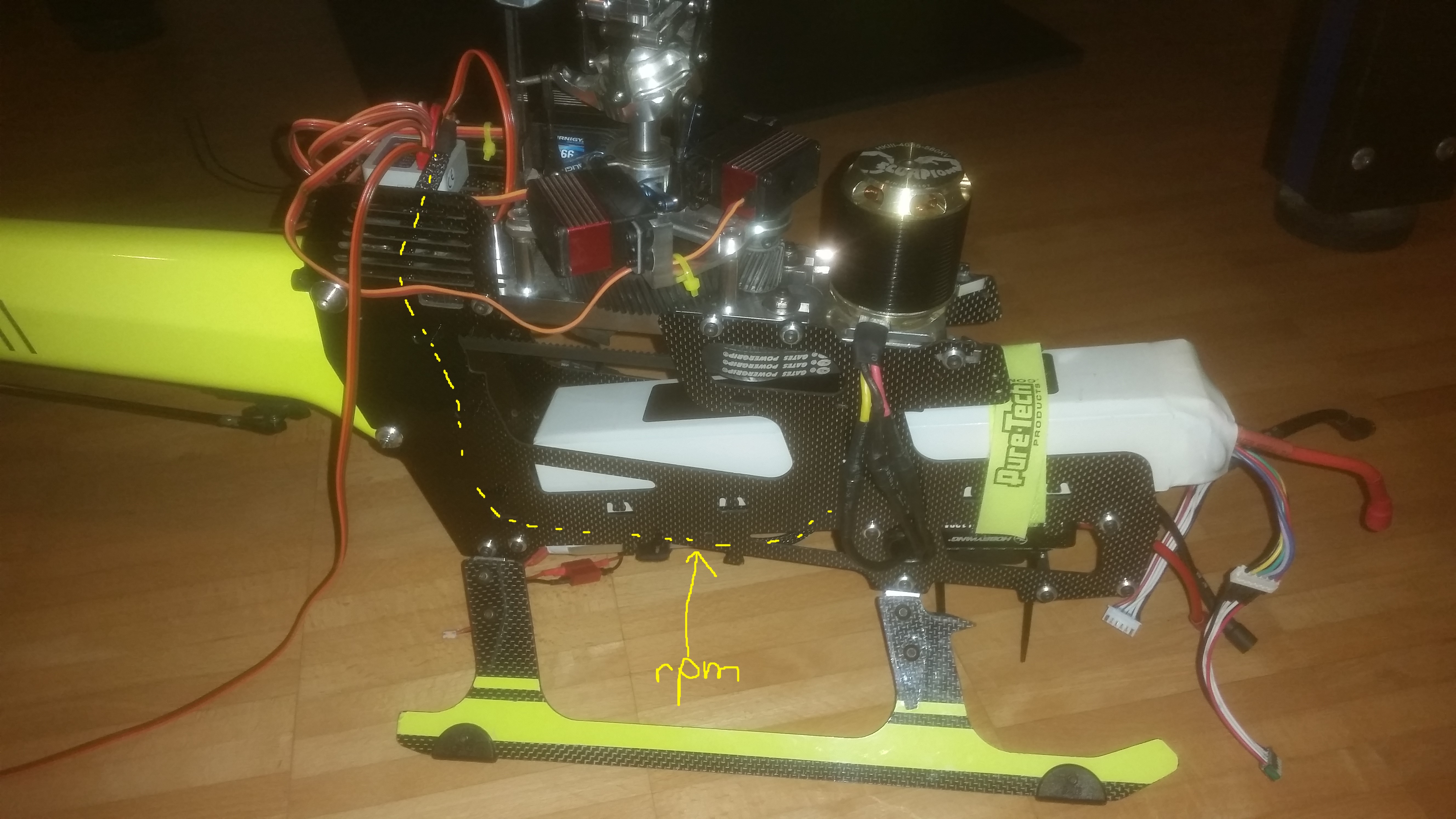

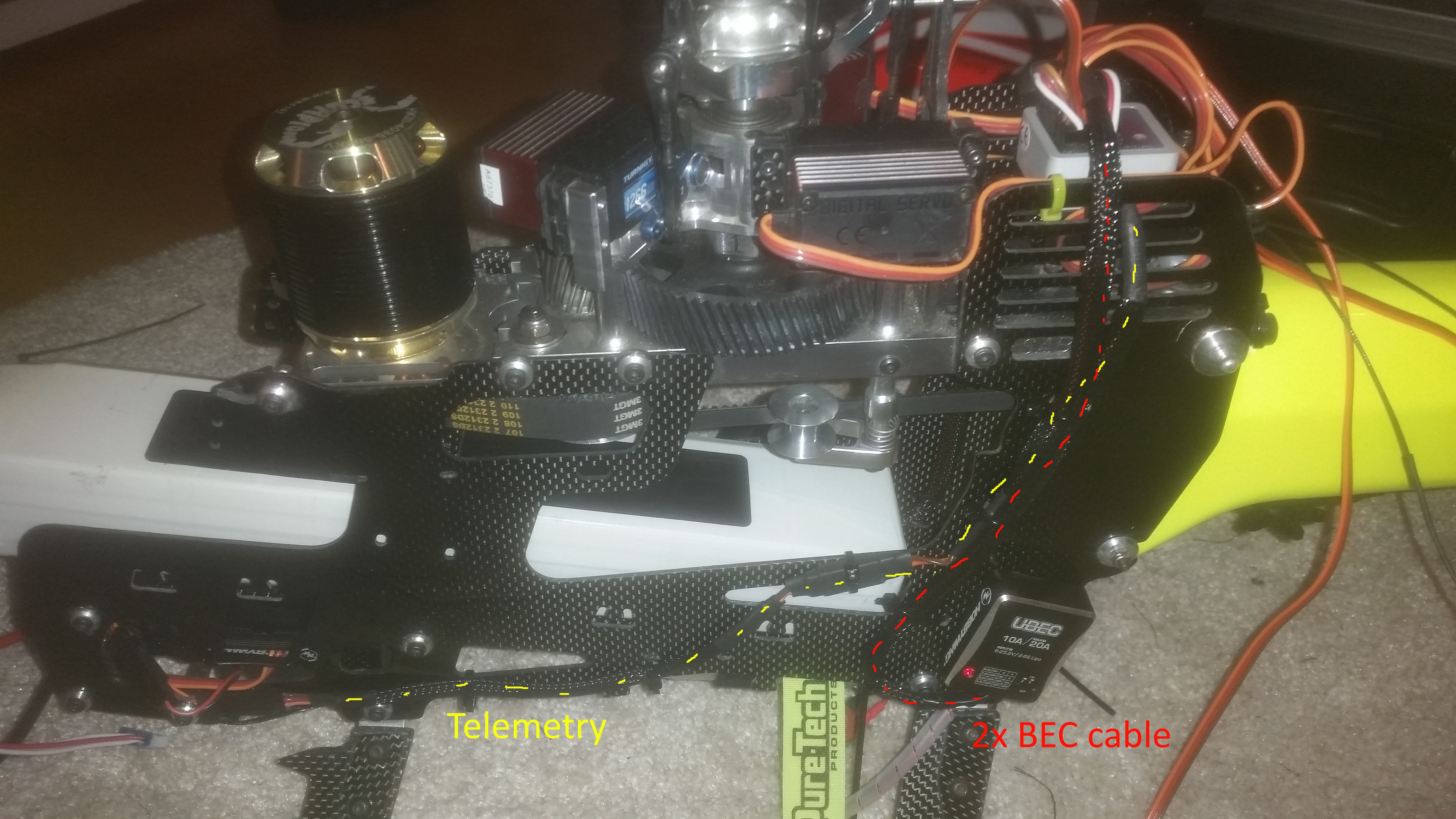

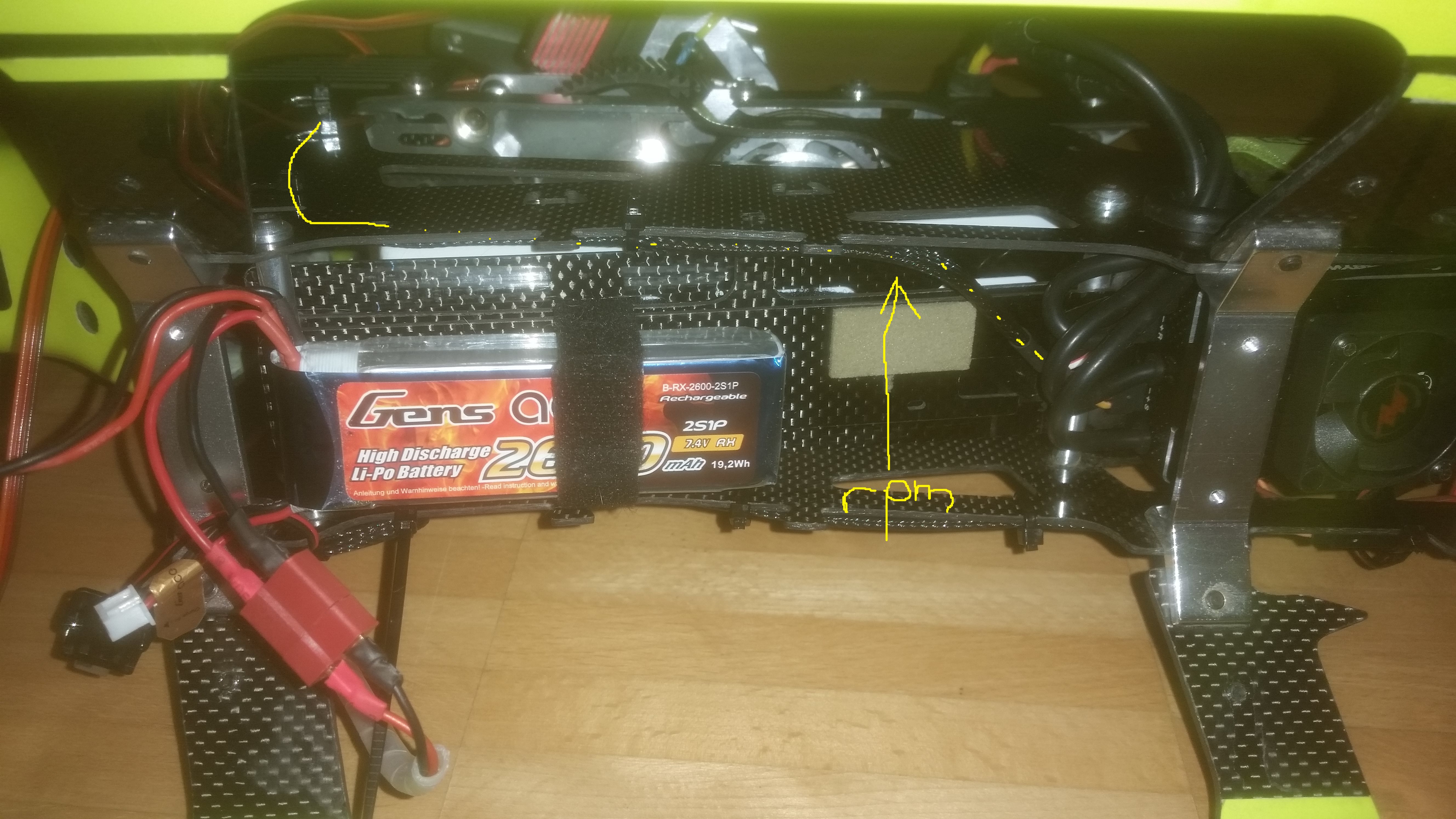

The rpm signal is working, but i have too much noise (i did not connect the hw fan on the esc). May I ask you for a suggestion what to change in order to get the noise down based on your experience? There are many options to try out and see if it helps but maybe you know the solution with the best chances to work properly.
I see the following problems:
- rpm signal runs together with throttle (signal,+,-) cable
- rpm cable runs relatively close to the battery; could this be an issue?
do you think just spliting the paths of the throttle and rpm cable could solve the issue?
i didn't use any of the ferrit rings that came with the hobbywing ubec. is it possible that the bec cables infer with the rpm cable? they are far away and only come near on the sockets of the spirit unit. so i thought this isn't an issue...
could i run into troubles running the telemtry cable next to the bec cables? should i isolate them more?
