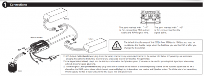

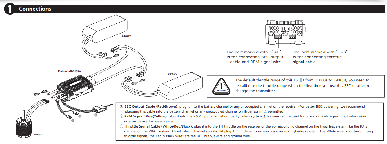

The Hobbywing has 3 Connectors (see attachment): -+R, -+S, -+P. Since its an Opto i'm not sure which one belongs where. Do i only have to attach (3) Throttle Signal Cable to the Spirit Pro? Do i need to plug all 3 pins from the Throttle? Should it go to AUX1 and therefore move the external BEC to AUX2?
To connect the telemetry from the HW -> Spirit this cable should be used: http://manual.spirit-system.com/index.p ... _Telemetry. Can i attached it using a Y cable on the Programming Port since im running the ESC using the fan?
Is it correct that i don't need the -+R port since it's an Opto (no BEC output) and the RPM signal is not used (->telemetry...)

Your connection scheme seems to be correct, except AUX1. AUX1 is used as Throttle output for the ESC.
For external BEC I recommend to use AUX2 and/or CH0 ports.
You do not have to connect -+R since Telem UNI cable has GND wire too. So you only have to connect throttle cable. You will not need to connect middle pin (red) from the throttle connector - to be safe.
Yes, you can use programming port for fan (including Y-cable).
