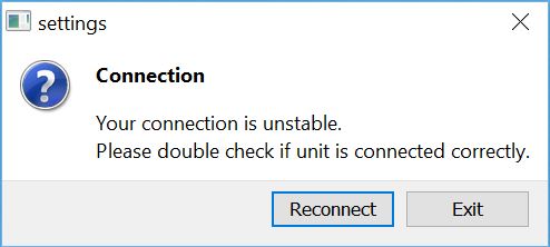

I did another test: with only Slave-BEC in AUX1 and the Nick-Servo (CH2) connected the unit stays in "sleep-mode" after booting.
I couldn't get a connection via USB so I added the receiver (RUD-Port and AIL-Pin). This way I copuld get it out of "sleep mode".
Interesting detail: while giving nick-input the unit stays awake even if the input doesn't change, if I activate the rescue mode it goes back to sleep after 1-2 seconds and I get the following message from the usb-connection:

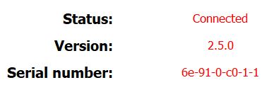

So, at last, here's the serial number of the device:
I'm afraid there's nothing more I can do and the the unit packed and send back to you!?
