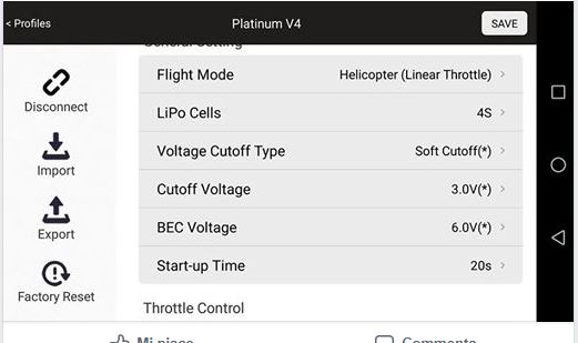

but the soft start in my esc does not work in any way, both with governor enabled and disabled, in esc and with governor enabled or disabled in spirit. always starts in the same way the motor, slowly then suddenly accelerates
the governor has only one flag to enable it from the Governor / throttle setting tab?see attachment and see again if u can my setting of th esc

I tried the first 3 options remaining the governor in the spiritalways disabled , and only the first fixed wing the motor starts immediately, the other 2 option , the slow start , but fot little seconds...then after 3 sec it accelerates a lot like in the video I showed you but I set a spool up value of 20 sec in the esc settings.
I then tried to exclude the esc governor, using option 2 in the esc which means using external governor, and I only enabled governor of the spirit one with spool up very slow, and 30 us, but it's the same thing always starts as in the video i have show you...

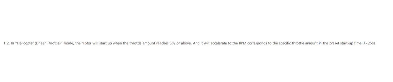

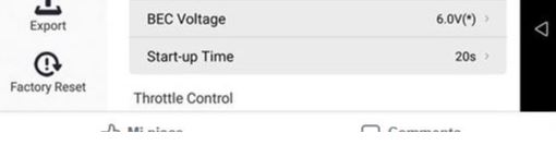

So maybe I badly mean softstart ? So what does 20 sec mean as a value in my set app of esc?"start up time"see attachment
Pino74
Posts: 192
the problem is that the Esc HW 60 amp manual is wrong, there are conflicting entries. look at the attachments.

urgno
Posts: 274
Pino74 wrote:the problem is that the Esc HW 60 amp manual is wrong, there are conflicting entries. look at the attachments.
why wrong ?
is clearly written that startup-time is only valid in ELF or Store Governor mode
you was using Heli Linear Throttle
Pino74
Posts: 192
in the same manual there is this line which is discordant with Start up time,
if the "start up time" works only in elf and store mode, they were wrong to write in the same manul of HW 60 amp,that in external helicopter linear, it(Start up time) has the same effect
