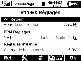

Good. Could you try to change Frame rate? Default should be 17ms.
Can you verify what is current settings? It can be configured in your receiver (Device Explorer).
Re: troubles reset module on Trex 700 nitro

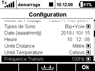

Posted: Tue 15. Oct 2019 9:24:59
by passe partout
OK there is "auto" and the frequency has been changed to 100Hz for more smooth movement.

100Hz settings is good.

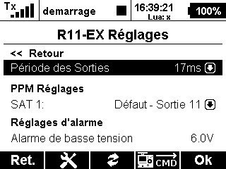

Please verify how Output period is configured in your receiver.
Default is 17ms. How it is configured in your receiver?
Changing the value could help.
Could you also show me how General/Channels is configured please?
You can attach you 4ds file or take a screenshot.

There is still a problem, the helicopter is flying, but I have to start several times before it works well.
