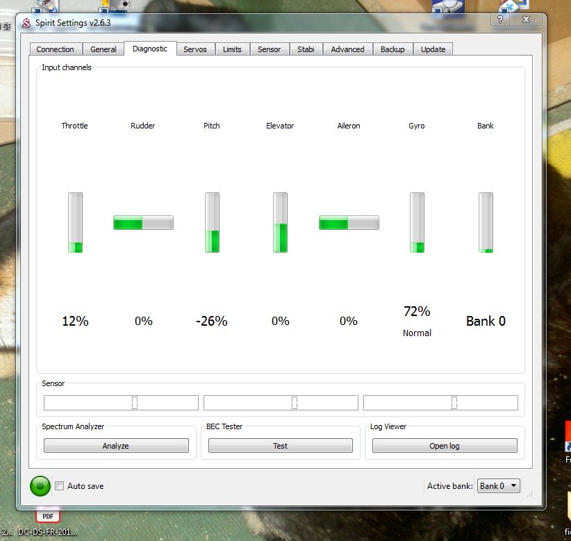

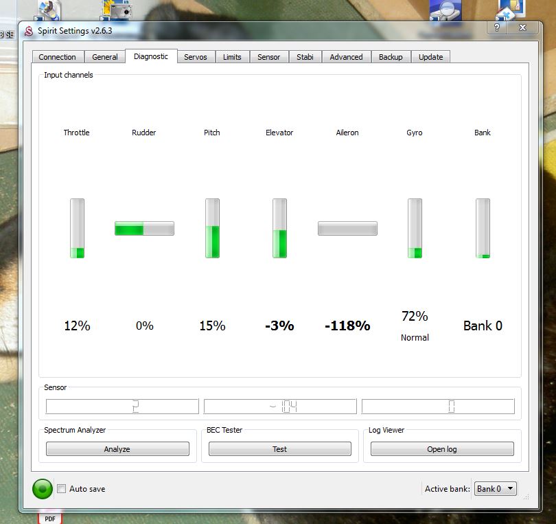

For photos, I just turned on and off at least 15 times there was the problem once.
It's very random.
NOT OK
OK

Thank you for the details!
Now it is clear the problem is somewhere between Spirit and receiver.
What protocol do you use (What Receiver type is configured)?
Is it EX Bus?

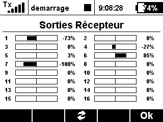

Posts: 13054
Yes, the problem is not in the servo.
For me it look like radio itself is sending a wrong value.
Could you please verify Servo monitor in your radio? Is Aileron channel in the middle (0%) when problem occur? Or is it showing same problem as in Diagnostic tab of the Spirit Settings?

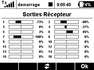

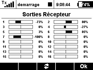

Ok here are the RX outputs (exit 2)
with the stick failure to neutral
with the right stick fault
with the stick failure left
the board on the helicopter does not move when I move the stick
