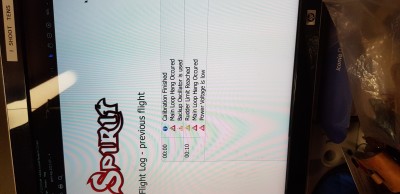

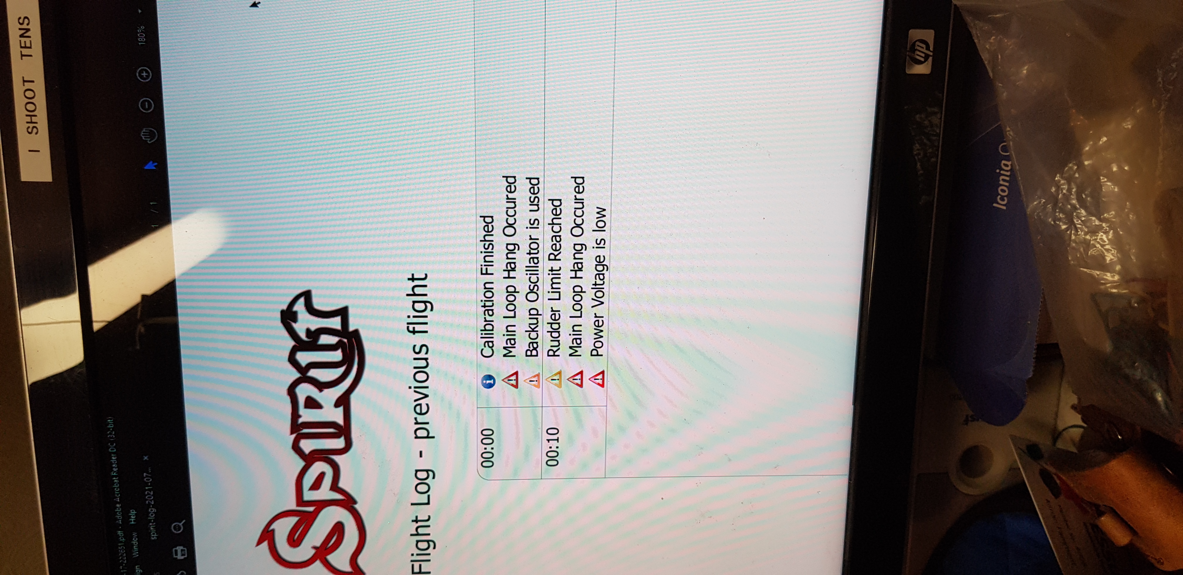

10x
Posts: 192
Hello Tomas
Still getting this fault, here is a log taken today after problem...
Picture attached....Hope this will help...
Regards Adrian

Hello, the problem reappeared. So it looks like the buffer was not the problem. But, when I look at the picture of the log, maybe it is a problem with the voltage. At the second try, the unit is preloaded and voila it starts. It is just a guess of me.
Heri
