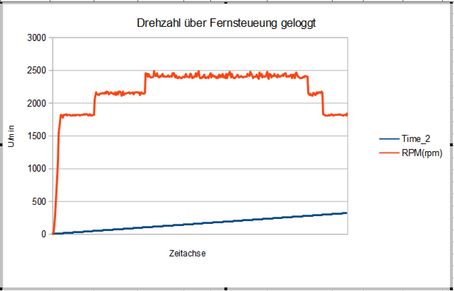

here you get additional information, I logged the RPM over my transmitter, here you see that the
RPM values are all valid and do not deviate as much as in the SpiritSettings log - if the transferred values were wrong, then I would also have such utopian RPM values - I suspect that an error may have been made during data processing/data evaluation (diagram in SpiritSettingsLog) - the correct RPM values were displayed and logged in my remote control -
I think that's easy to correct, maybe you didn't notice that until now -
A note on the diagram, the last value logged is the first speed level (approx. 1800 rpm) for landing, the data log stopped after pressing Throttle Cut - therefore no end with speed "0" (UMin) !

Can you please send me also your settings? I am asking to find if Gear Ratio and Sensing Divider are configured correctly.
Your telemetry log from radio looks good.

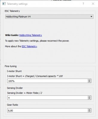

here the configurationfile of the SpiritGT and some other pictures and information -
My gear ratio ist 8,83 set as 8,8 (Pinion 12 teeth, Main gear 106 teeth) - The Motor is an XNOVA Lightning 1000 rpm/V, 8 poles - Sensing divider as 4 (8/2)
Battery is an 6S 5000mAh -

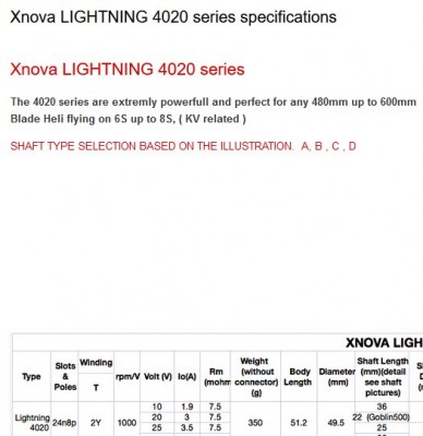

The motor:
In my opinion Sensingdivider and gear ratio configured right -
I hope this will help -
