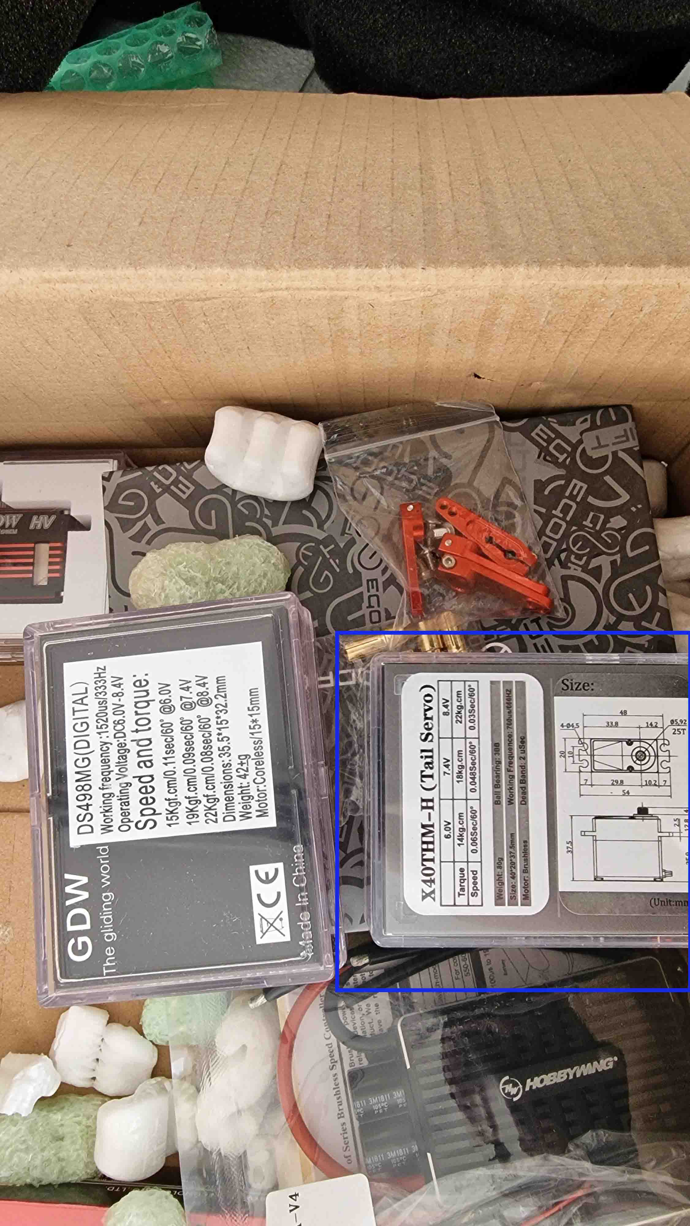

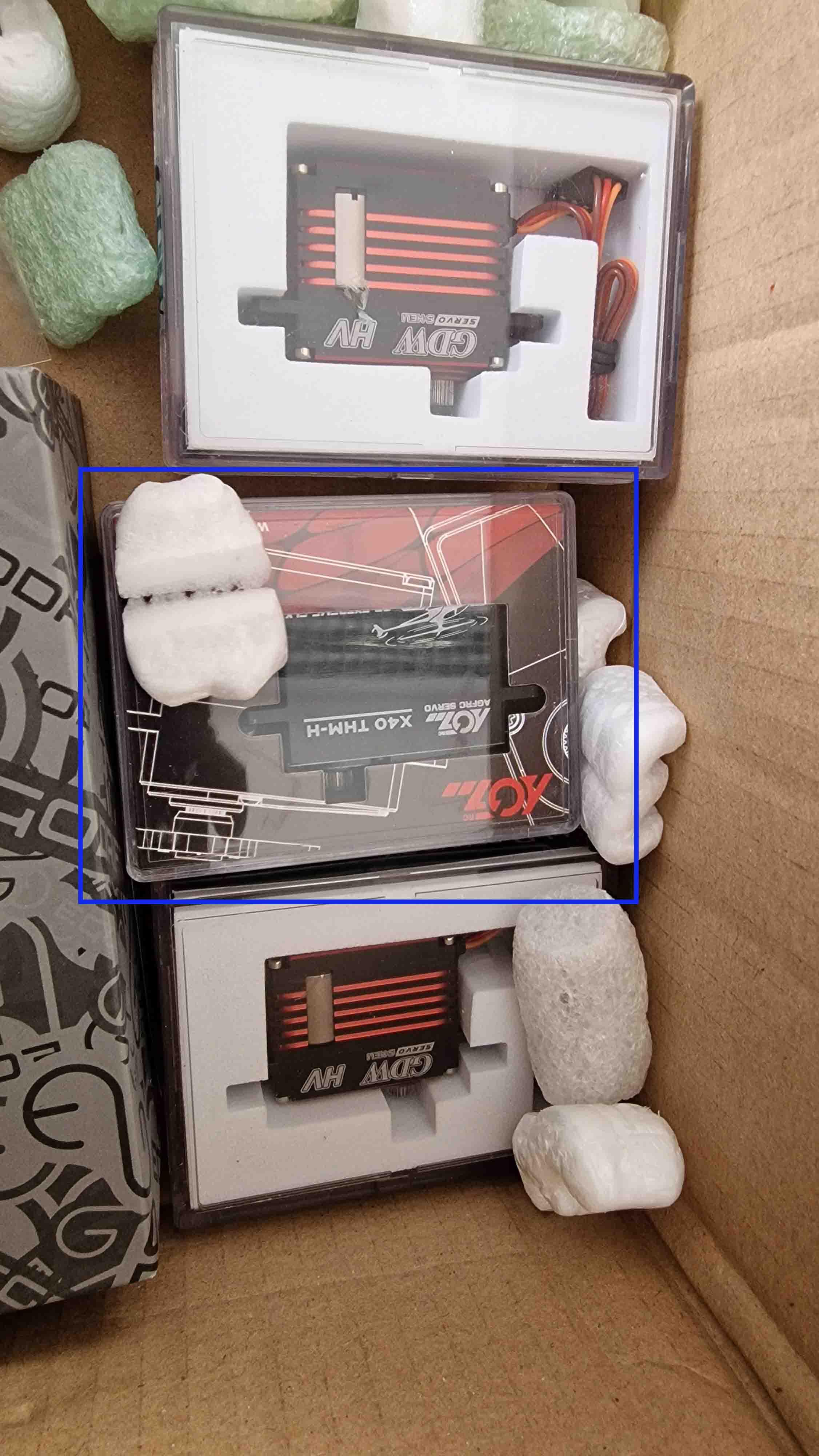

zexx86 tail servo X40THM-H gdw how much should I put the servo delay? now is 5 but it is not in the list and my tail it's slow, before increasing the parameters I want to fix the delay
Posts: 13045
I can't find your tail servo anywhere. Probably it is called differently. Please check the name and correct it or send link of the manufacturer.
franz88
Posts: 343
it says on the box https://www.agfrc.com/
the one with the blue rectangle
it says aol but i believe it is agfrc
Posts: 13045
you can set Rudder Delay to 0-2.
Pirouette Consistency to 175 - 185 should be fine.
