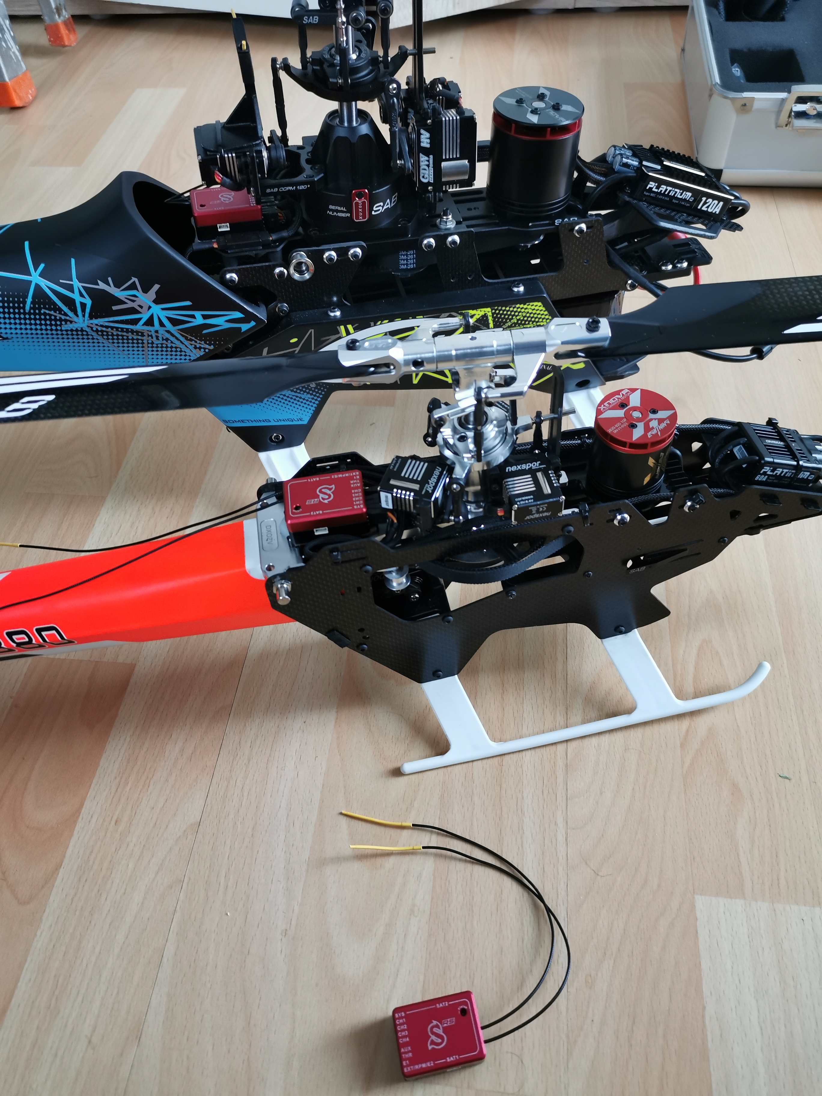

Hello, please send a photo of the helicopter as you try on the table.
Don't you have too close to the radio? ... at least 50cm from the receiver antenna.

It's unclear why you asking for, however.
Attached all 3 units, before update all
3 units works fine, same distance....
I'm really not a newbie.
2 units on 2 different Helicopter
1 unit dismantled of the 3rd Helicopter.
All 3 units seeable on the picture.
