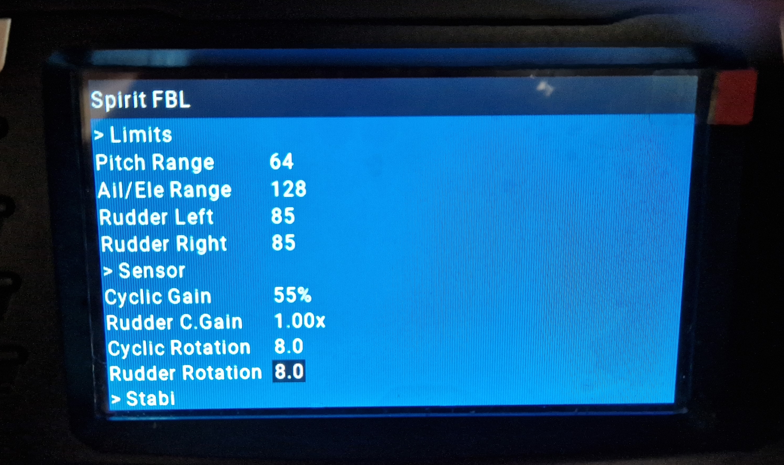

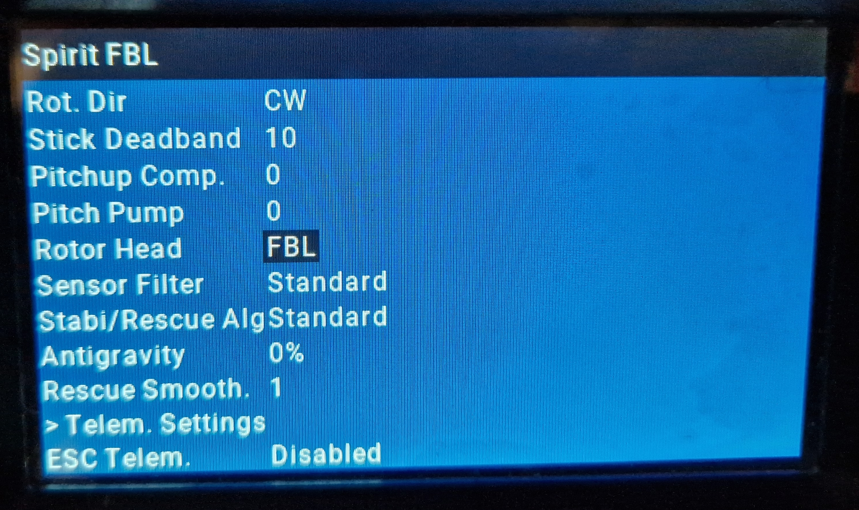

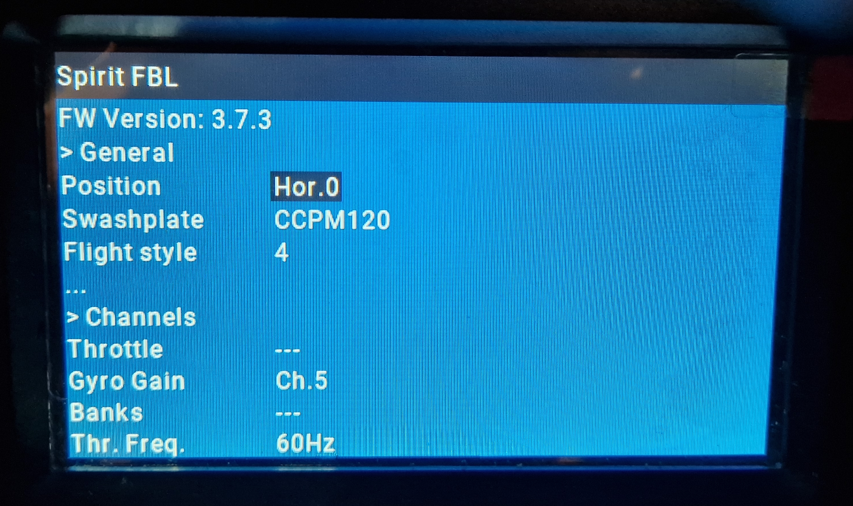

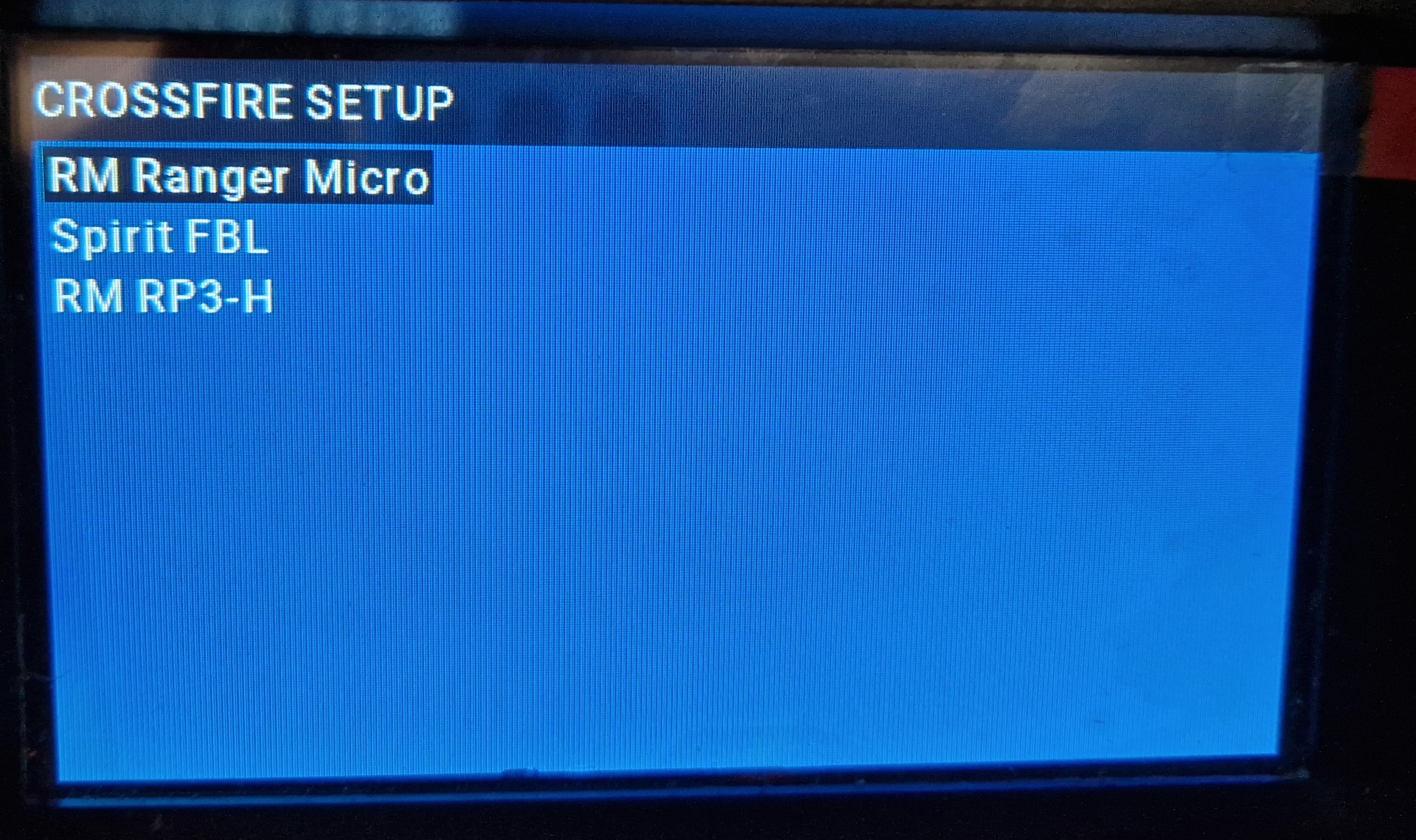

We assigned firmware to these that sent me a message.
Compatibility with all ELRS receivers should be perfect now while all recent Spirit units have full Spirit integration now. Photos in the attachment below.
