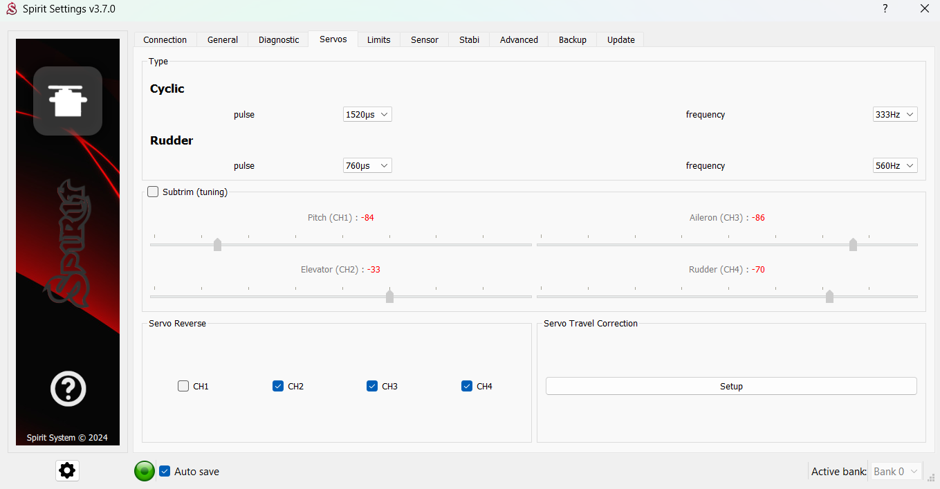

what center pulse rudder you have set in SERVOS - TYPE ?
for servo rudder 3515t is exact pulse center 760us
OMPhobby M4 max with Spirit GT 3.7.0 tail wagging
Hello Franz, the center is set to 760, see attached screenshot.

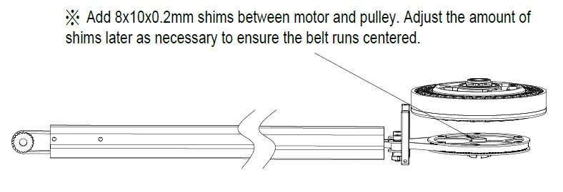

I had nightmares with the tail and I also listened to Franz88's advice and he was right about the tail control having to be smooth. However, there was still a bit of oscillation that was eliminated by inserting a shim between the gear wheel (for the tail belt) and the motor. In fact, when held up to the light, you could see the belt was not centered with the wheel.
La pagina del manuale in italiano è 22. In allegato l'img della shim

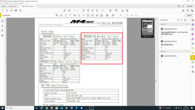

I had tail wagging in 2 helicopters (not M4 max) and in both cases the problem was solved after replacing the tail servo with a better servo. To test whether the ESC is the cause of tail wagging, you can set P and I to 0 for a short test flight. I use Spirit GTR and YGE. Especially in M4 (not max) the tail servo is slow.
Of course I agree with franz88 that the tail mechanics has to be smooth first before you try other things.
